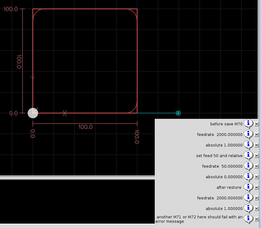

30 Mar 2016 10:56 #72378 by fupeama
Replied by fupeama on topic save and restore path control mode
thanks for your help.
I studied everythink about M70 . But it looks lile this command save only MOTION_CONTROL_MODE G61 vs G64 not MOTION_CONTROL_TOLERANCE. P parametr on G64
I tried this ngc
; using M70/M71/M72 at the top level
F2000.
S1200
G90 (absolute mode)
g64 p0.001   (-------------------------------------P 0.001----------------------------------)
g0 x0 y0
g1 x100 y0
g1 y100
g1 x0
g1 y0
(DEBUG, before save M70)
(DEBUG,feedrate  #<_feed>)
(DEBUG,absolute #<_absolute>)
M70 (save state)
f50
s120
g91 (relative motion)
g1 x5 y5
g64 p20   (---------------------------------------------------P20-----------------------------------)
(DEBUG, set feed 50 and relative)
M72 (restore without invalidating - multiple use possible)
(DEBUG, after restore )
g0 x0 y0
g1 x100 y0
g1 y100
g1 x0
g1 y0
M71 (restore and invalidate)
(DEBUG, another M71 or M72 here should fail with an error message)
; M71
M2
first rectangle has sharp corners p 0.001, but second has arc in corners because M72 dont restore cam tolerance parametr and P20 is used instead of
