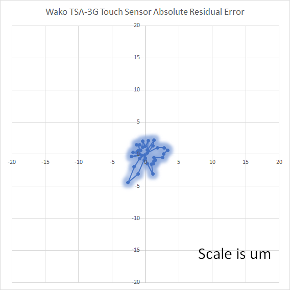

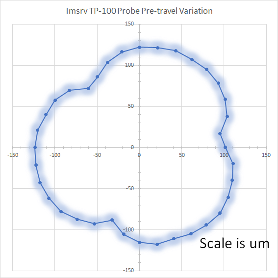

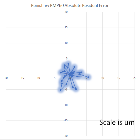

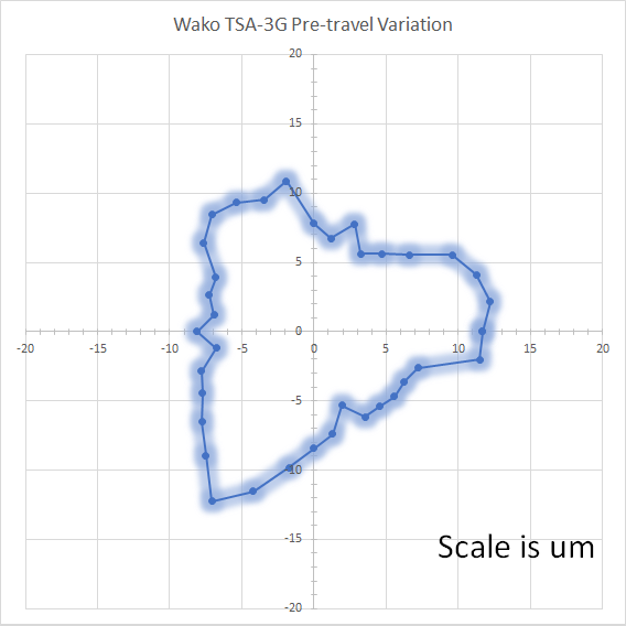

I have been working on adding some probe calibration buttons to probe screen (and other improvements) as well as some probe characterization functions. plopes9000's post was an inspiration to work on this. The main reason for me to work on this was because I wanted to add support for automatic xy error removal when spindle orientation is present. So far I have both sphere and ring gauge calibration standards working with an arbitrary number of calibration points.
Data was gathered with 10 touches each at 10 degree increments. The 10 touches were averaged to remove contact variation and also used to determine the variation. The pre-travel plot is the probe error when using the physical probe ball diameter and not the corrected diameter. The residual error is after the probe pre-travel has been removed by using the electrical probe ball diameter instead. The shading in the plots indicates the 95% confidence interval. All plots have probe center alignment calibration applied.
As my machine has 1um resolution on the encoders I consider anything around 5um to be good enough. Both the renishaw and wako probes were able to be calibrated to around 5um with a x-y offset and probe ball diameter correction as seen in the residual plots. The 95% confidence variation on both probes was about 1.2um so they are likely repeating better than I can measure on my machine. Both probes are good to 15um with only x-y calibration.

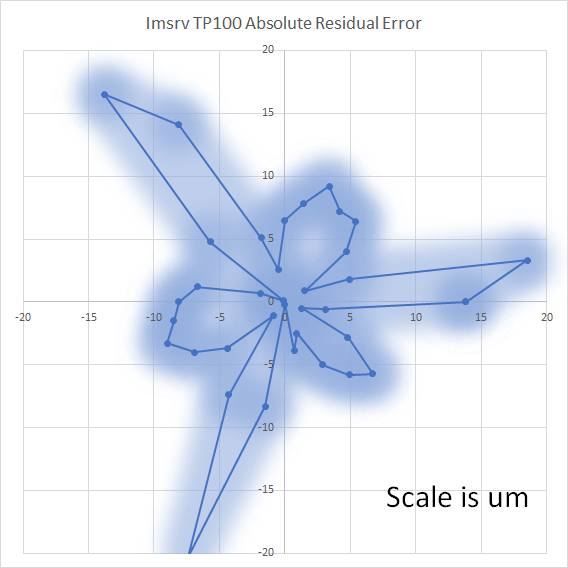

For the Imsrv TP-100 the story is a bit different. This probe is a low cost unit priced at about $250 that I picked up many years ago when I started out with a Taig CNC. I think it would be fairly representative of hobbyist level probes. It is a simple switch with no resistive sensing as is used in the renishaw to improve sensitivity. This is apparent in the pre-travel plot where the travel to trip is around 120um. The variation is also much higher with a average 95% confidence variation of 4um and a maximum of 10um. Probe diameter calibration is required for this probe to be accurate on just about any machine. After probe diameter calibration there is still about 20um of error. It would be possible to compensate this using either a curve fitting or multi point approach. I was thinking of implementing a multi point calibration but I am not sure how many would benefit from it. It would only apply when using a low cost probe on an high resolution machine.
PS Yes I know they should be polar plots but I haven't figured out plotting in python yet and excel doesn't have polar plots
