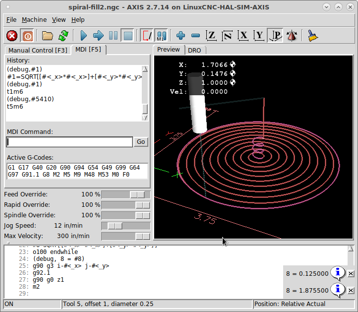

I was working on a small parametric G-code file that is supposed to spiral mill a circular pocket.
I am running into two problems. The 1st problem was that my while loop was executing one extra loop regardless of if I use LT or LE, for my watched parameter I get the same result. I've worked around this by subtracting 0.0001 from the comparison and seems to give the correct results for everything I've tested so far.
The other problem that I really don't understand is, after the while loop is completed the program is supposed to make a circular finish cut, but sometimes with certain combinations of %overlap and pocket diameter, Linuxcnc completely skips that last circular cut. Is this some sort of an interpreter bug in Linuxcnc? (I am getting these results testing on Linuxcnc sim installed from the R13 Stretch testing ISO on a VM.)
Here is the g-code if you want to test it yourself. If you change #5 to some other number like 50 the program runs as intended.

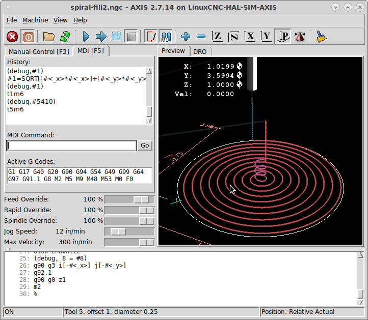

The % and upper/lower case have no effect.
Running my code above gives the error where it doesn't mill the finish pass.
If I change the value of parameter #5, valuses 25,26,27, 36, 40 all make the error, but 20-24, 28-30, 35, 42 and 50 do not.
In the attached screen shots you can see that the white line was not exicuted, in the 1st image, and it was in the 2nd. (the retract line after the circle always is executed.)

So, is there any chance that the interpreter was crashing due to being asked to calculate the sqrt of a negative number?
