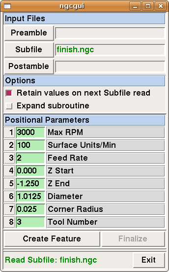

This one is for a face cut with a radius at the edge of the diameter and a diameter final cut.
Attachment finish.txt not found
Enjoy
John

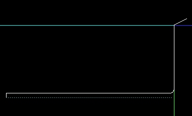

12 Aug 2010 22:29 - 12 Aug 2010 22:29 #3726 by BigJohnT
Replied by BigJohnT on topic Re:Lathe Finish Cut with Radius
This is the path created by the subroutine.
John
