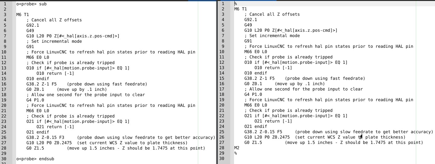

this problem is not resolved yet?
I have tested and have the same problem on LinuxCNC 2.8.4
EDIT: I have this error using a subroutine to call the change tool and probe length, if I do it in a normal GCode file it do all correctly.
With
O <touch_plate> sub
M6T1
O<set_tool_length> call
M6T2
M6T3
M6T4
M6T5
M6T6
M6T7
M6T8
M6T9
O <touch_plate> endsub
M2it fail with error, but if I do it in a normal .ngc file:
M6T1
M6T2
M6T3
M6T4
M6T5
M6T6
M6T7
M6T8
M6T9
M2LinuxCNC do all correctly

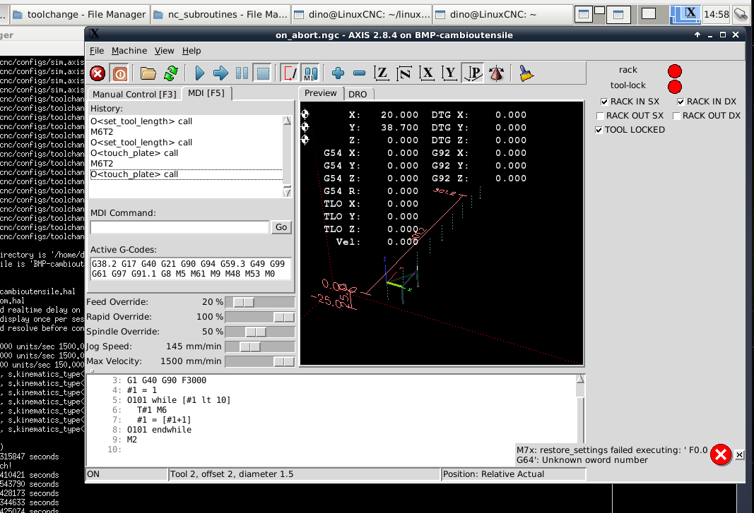

27 Feb 2023 00:59 #265464
Or is that used also for error reporting?
Replied by tommylight on topic M7x restore_settings failed
Screenshot, bottom right side, error ?
He is just using a shortcut to mean M70 and M72.M7x is not a valid M code, probably inside the "touch_plate" file?
27 Feb 2023 01:05 #265465
Replied by andypugh on topic M7x restore_settings failed
It's this error message here:
github.com/LinuxCNC/linuxcnc/blob/2.8/sr...erp_convert.cc#L2905

28 Feb 2023 21:57 #265619
by dinodf
Replied by dinodf on topic M7x restore_settings failed
I think that is not a problem made by M2
The error occurs only when executing the procedure with no tool, if before run the procedure I do T2 M6 the procedure don't fail!
So I think there is some variables not initialized at startup and when LinuxCNC try to restore global settings it fails with an error...
A workaround is do an unnecessary tool change before starting the procedure to set all the variables used.
if (status != INTERP_OK) {
char currentError[LINELEN+1];
rtapi_strxcpy(currentError,getSavedError());
CHKS(status, _("M7x: restore_settings failed executing: '%s': %s"), s, currentError);
}A workaround is do an unnecessary tool change before starting the procedure to set all the variables used.
