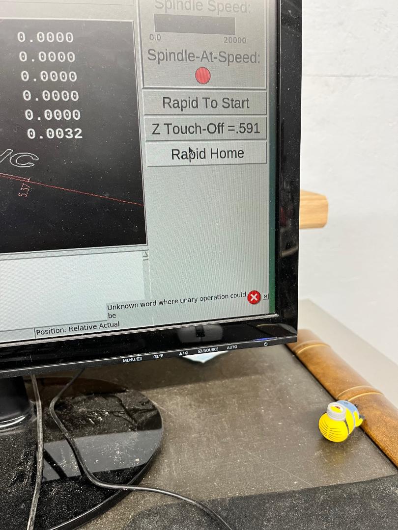

Hello, I am having trouble setting up my Zaxis tool touch block. I have it running but it faults after it finishes the second G38.2 touch off. The error I get is Unknown word where unary operation could be. If I comment out the G38.2 stuff and do a simple move with this button and subroutine it works fine.

# is not a comment. Use ";" instead.

Sorry I am not following will you please use it in a command so I can understand? I have always used # to comment out stuff in the .INI, dose it not work in subroutines?

No, in g-code files it is different.
As Hakan already said you use the " ; " there.

Thank you Hakan and mgm it is clear to me now.

A quick update. The issue was actually that I had activated the Classic Ladder and checked probe in the Advanced Tab in PnCConf wizard and forgot that I did that.
Once I turned off did that and uncommented the other issue everything worked.
Thanks for the help!
