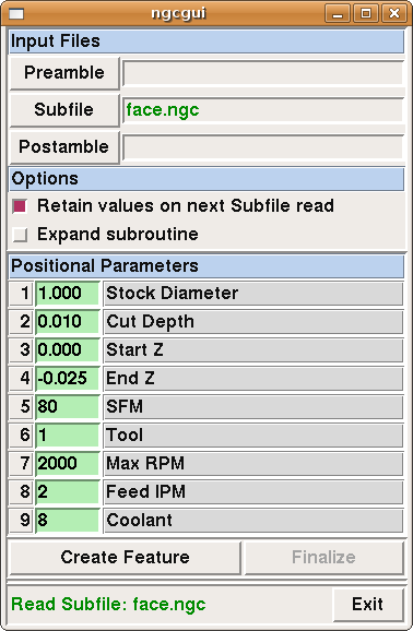

Here is my Facing subroutine. It ends at the Z of the last cut so you can set Z0 offset and it uses the tool table tool diameter so make sure that is set properly.
Attachment face.ngc not found
Enjoy
John

I've updated this one to give you the option of setting the Z 0 at the end of the cycle.
John
