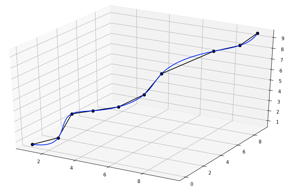

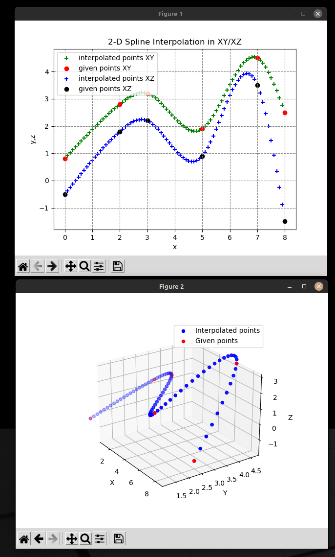

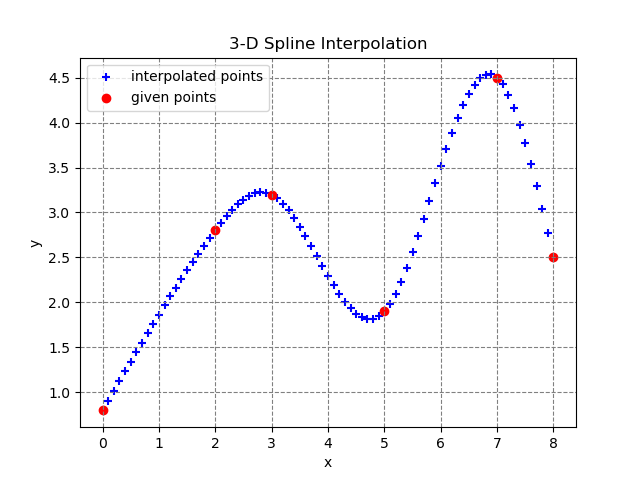

10 Oct 2024 08:38 #311711 by jurod
This code should be correct on a 3d spline

A curve in the XY plane is a 2D curve even if the title says '3-D':
[edit]
So basically you would need to run this for XY and XZ coordinate pairs separately and then reconstruct the XYZ coordinates. Shouldn't be too difficult really.
Last edit: 10 Oct 2024 09:25 by Aciera.

gives me this:
Which looks ok.
