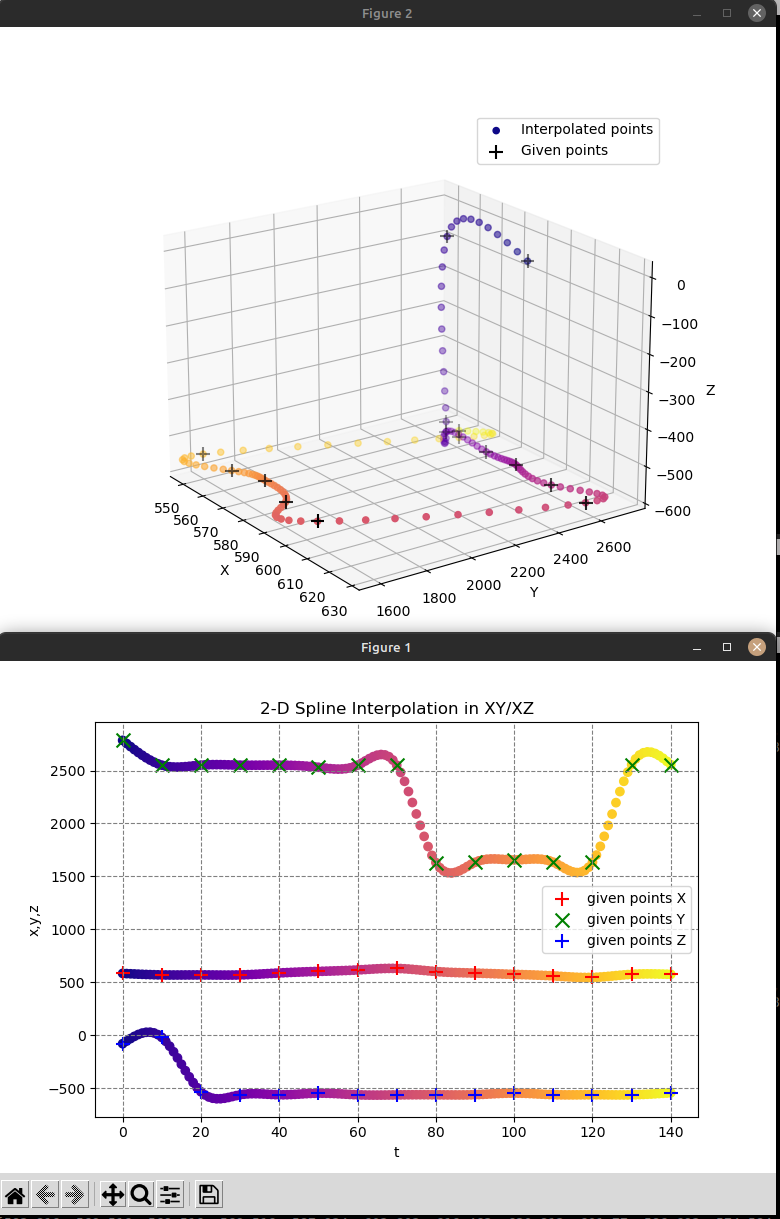

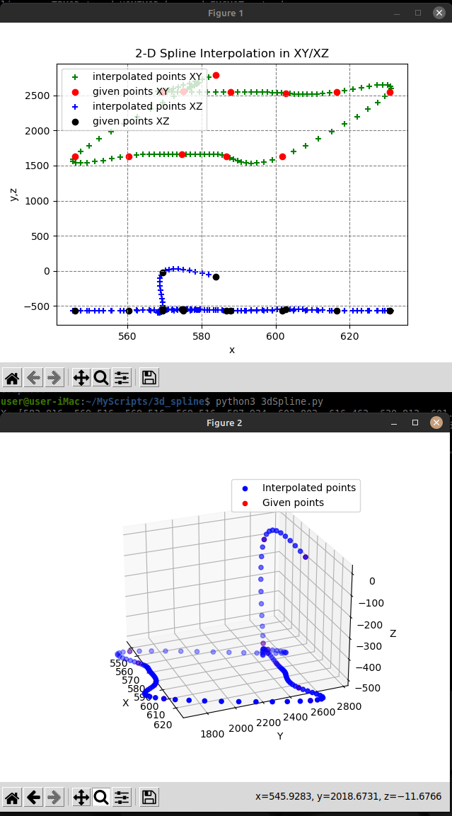

10 Oct 2024 09:08 - 10 Oct 2024 09:30 #311727 by Aciera
Modified the script to accept any sequence of point coordinates (x,y,z) read from a file called 'points_input.txt' in the same directory as the '3dSpline.py' script and outputs the interpolated points to a file called 'output_file.txt':

The 'points_input.txt' for the example below:
[code]583.8160, 2785.3929, -80.0100,
569.5160, 2551.3630, -20.8590,
569.5160, 2551.3630, -534.4340,
569.5160, 2551.3630, -563.0960,
587.9240, 2551.3630, -562.6310,
602.8020, 2531.2934, -547.8260,
616.4620, 2550.4623, -563.0180,
630.8120, 2550.4623, -563.9780,
601.7700, 1631.0440, -563.0410,
586.6920, 1633.2648, -561.9940,
574.5840, 1656.0775, -546.8950,
560.3560, 1634.1061, -561.9290,
545.8120, 1634.7045, -562.6420,
575.0200, 2556.2819, -563.3090,
575.0200, 2556.2819, -543.9050,
which gives me this output:
  [/code]
And the 'output_file.txt' content created:

10 Oct 2024 10:56 - 10 Oct 2024 10:56 #311748 by Aciera
Just as an explanation.
The script basically calculates a spline for each axis separately (ie one of X, one for Y and one for Z). The resulting 3D curve is the combination of the individual x,y,z values at a given iteration index (t):
Last edit: 10 Oct 2024 10:56 by Aciera.

10 Nov 2024 11:46 - 11 Nov 2024 10:50 #314195 by jurod
Very well. Thanks.
I also made adjustments for the XYZA and XYZBC axes.

if __name__ == '__main__':
    # (N + 1) points
    T,X,Y,Z,B,C = [],[],[],[],[],[]
    fileName  = './points_input.txt'
    import csv
    with open(fileName, 'r') as f:
        reader = csv.reader(f)
        point_data = list(reader)
        for line in point_data:
            X.append(float(line[0]))
            Y.append(float(line[1]))
            Z.append(float(line[2]))
            B.append(float(line[3]))
            C.append(float(line[4]))
    print('X:', X)
    print('Y:', Y)
    print('Z:', Z)
    print('B:', B)
    print('C:', C)
    n=0
    for x in X:
        T.append(n+1.0)
        n += 1
    print('T: ', T)
    #T = [1.0,2.0,3.0,4.0,5.0,6.0]
    #X = [0.0, 2.0, 3.0, 5.0, 7.0, 8.0]
    #Y = [0.8, 2.8, 3.2, 1.9, 4.5, 2.5]
    #Z = [-0.5, 1.8, 2.2, 0.9, 3.5, -1.5]
    S   = 0.1        # Step for interpolation
    S_1 = 1 / S      # Inverse of S
    xs_g, ys_g, zs_g, bs_g, cs_g = [], [], [], [], []  # List for graph
    try:
        # 3-D spline interpolation
        si = SplineInterpolation(T, X)
        for t in [t / S_1 for t in range(int(T[0] / S), int(T[-1] / S) + 1)]:
            x= si.interpolate(t)
            #print("{:8.4f}, {:8.4f}".format(t, x))
            xs_g.append(x)
        si = SplineInterpolation(T, Y)
            y = si.interpolate(t)
            #print("{:8.4f}, {:8.4f}".format(t, y))
            ys_g.append(y)
        si = SplineInterpolation(T, Z)
            z = si.interpolate(t)
            #print("{:8.4f}, {:8.4f}".format(t, z))
            zs_g.append(z)
        si = SplineInterpolation(T, B)
            b = si.interpolate(t)
            #print("{:8.4f}, {:8.4f}".format(t, b))
            bs_g.append(b)
        si = SplineInterpolation(T, C)
            c = si.interpolate(t)
            #print("{:8.4f}, {:8.4f}".format(t, c))
            cs_g.append(c)
        # Write output to file
        file_out = 'output_file.txt'
        print('Writing output to ',file_out)
        n=0
        output = open(file_out, 'w')
        for x in xs_g:
            string=("G1 X{:4.2f} Y{:4.2f} Z{:4.2f} B{:4.2f} C{:4.2f}\n".format(xs_g[n], ys_g[n], zs_g[n], bs_g[n], cs_g[n]))
            output.write(string)
            n += 1
        # Closing file
        output.close()
        # Graph drawing
        g = Graph(X, Y, Z, xs_g, ys_g, zs_g)
        g.plot2d()
        g.plot3d()
    except Exception as e:
        traceback.print_exc()
        sys.exit(1)
