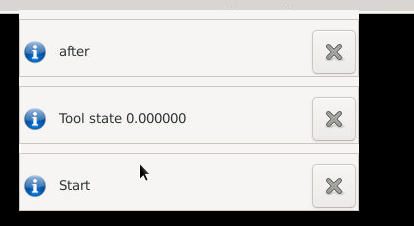

Hi all, hope you can help.
Having a issue when trying to use a while loop. I am using lcnc 2.9.3 & gmoccapy 3.4.8
But lcnc just freezes or really slows down the system when the comp turns true, see below 2 examples that work and two that dont.
the only change is that it should go in to the while loop
I am trying to use imputsignals:
output: Start tool state 0.000000 after (edited)
output: Start tool state 0.000000 greater after (edited)
output = nothing, not even start
# ATC input signals net ATC_tool_in hm2_7i96.0.gpio.007.in => motion.digital-in-01 net ATC_tool_open hm2_7i96.0.gpio.008.in => motion.digital-in-02(msg, Start)
(debug, Tool state #<_hal[motion.digital-in-01]>)
o110 while [#<_hal[motion.digital-in-01]> EQ 1]
(debug, greater )
G4 P2 o110
continue o110
endwhile (debug, after )output: Start tool state 0.000000 after (edited)

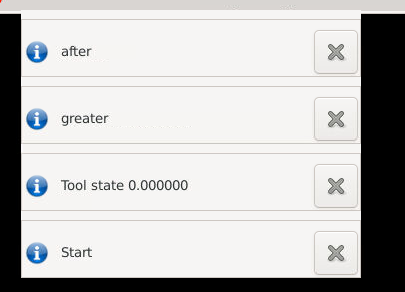

(msg, Start)
o110 do
(debug, greater )
G4 P2
o110 continue
(debug, after )output: Start tool state 0.000000 greater after (edited)

You can try M66 Pn Ln, then check #5399
linuxcnc.org/docs/2.9/html/gcode/m-code.html#mcode:m66
o100 do
M66 P1 L0
o100 while [#5399 GE 1]linuxcnc.org/docs/2.9/html/gcode/m-code.html#mcode:m66

Brilliante thanks.
Will try when I get back home from work.

Maybe the loop is not even needed. It should be possible, to just work with wait mode type Ln and if conditional to check value of #5399, depending on what you want to do

In this case I need it to retry a thing if it done succeed the first time so L0 seams great for now.
but so many possibilities when started to understand this! haha
