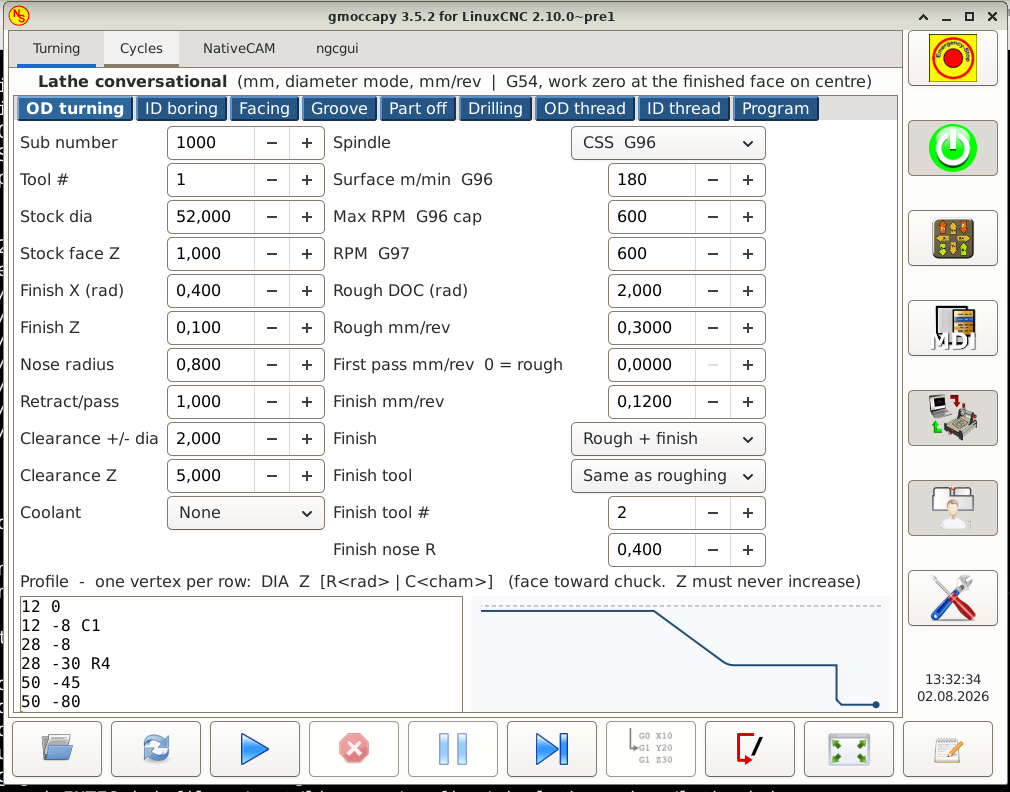

Hey guys just wanted to upload this config with a cnc conversational gcode software. I will try make some videos as this is the coolest thing ever i think. its all made with claude so i can't really take credit for it. but i have been machining for 16 years now and used fagor and semiens lathe controls with conversational software like shop turn. and this is the closest i could make to something like that. this runs as a embedded glade vcp tab in axis gui. so as simple as you can get with linuxcnc. and has no dependancy's that i could find, everything runs on python and there is no subroutines in the conversational software. so if you want to add this to your own config i think that all you will need to do is copy any python files you can find and add the right lines to the ini to load the glade tab which you can copy from my ini.
All code is long hand so no canned cycles. and the profile cycles are made based off the linuxcnc canned cycles.
you can reload a old program made with this back into the conversational software and make changes in a few seconds and re post it.
this is still a work in progress but its been running large cnc lathes for a few weeks and no issues so far. and you can see in the preview anyway enjoy and if anyone uses it let me know cheers. just hoping to give back a little to linuxcnc a bit and this has been massively missing for ages. even ecam only does mills i think.
if you want to install this i have made it as simple as i know how to.
step 1 if on a brand new install from the ISO then open the linuxcnc config picker first and open any sim. that will make folders for linuxcnc and configs etc
step 2 copy and past this file into the normal configs directory. and unzip or unzip before copying
open the linuxcnc config picker again and open this config. click desktop shortcut.
run it post code and have a look.
Ps just a few things to warn about. this uses chris morley's wear patch so t0101 and also uses g30 for tool change positiion. and assumes a encode for g33.1 tapping and for threading
this was tested today on a fresh install of 2.10 cheers

In my opinion, the better way is you collect only necessary files and say what we have to change in standard sim ini.
I did some test with config copied from sample-configs/sim/gmoccapy/lathe_configs.
This is gmoccapy and I recommend for you.
The 6,5 font size is not readable for me. I suspect this is from lack of space in Axis.
In gmoccapy you can safely use 12 font size.
There is one problem to solve - "generate & load" button works partially, generate, save, but not load. Manually loaded lathe_profile.ngc works as expected. Maybe rename button to "generate" only?
For me fanuc style Tnnnn is a problem. I never used this, don't want this, and tried to remove this "advantage", but no luck.
How to change sources for use standard Tnn tools?
I tested only "OD turning", seems this is good idea and good software, and worth to test the rest.

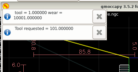

I found the solution for fanuc style tool numbers.
No changes to Becksvill's code, this will work anywhere.
1. Create settool.ngc file2. Add to your ini file in [RS274NGC] sectionNow, for example, tool 1 will be loaded even if there is T0101 in g-code and tool 101 is not present in tool table.
o<settool> sub
O200 IF [#<t> GT 100]
#<t> = [#<t> MOD 100]
O200 ENDIF
T#<t>
o<settool> endsubREMAP = T argspec=t ngc=settool

Hey Tuxcnc
just wanted to message back here and explain some of the reasons for the tool wear remap t0101 etc
On almost all commerical cnc controllers (fagor fanuc mazak misubishi semiens heidenhain (also Pathpilot which is sort of a commerical version of linuxcnc) you can change a offset to account for the tool wearing or machining cutting slightly the wrong size over time or part to part. usually you have a option where you can just change the value by 0.05 or something and it changes the size the machine cuts a bit. if you only use T1 m6 g43 then you have to adjust the actual tool geometry offset. which if you have boring bars and also turning tools can be like 300mm different. if you muck up your maths here or make a typo. i been there and done it then the next time you run the machine it crashes. and then also if you have a unskilled operator on the machine it's even worse. anyway all these issues are good reasons to have some way to make only small changes to the tool size. the T0101 remap is not the best way i could be quite happy with just t1m6 also if there is a good way to include wear offsets but i haven't seen one so i use the remap that chris morley made years ago. I have a production lathe that would have made 50,000 parts now and wear offsets are essential in my opinion.
I can probably change the cycles to output only T1m6g43 once i am finished if you want it. though your solution you showed seems to work.
cheers becksvill

But when you share your project with others, you may find that they have different needs and preferences.
I suspect that the vast majority of LinuxCNC users use the standard M6Tn, have programs that use M6Tn, and tool tables that use M6Tn.
When standard LinuxCNC receives, for example, M6T7777, it will look for tool number 7777 in the table and if it does not find it, it will display an error and terminate the operation.
The solution to this problem is very simple - let the user decide whether he wants to use Tn or Tnnnn.
I suspect that you know your program and add one more button is not much work for you...
Replied by tuxcnc on topic Conversational CAD CAM
You have the right to use what you need, it doesn't matter why you do it and you don't have to explain it.just wanted to message back here and explain some of the reasons for the tool wear remap t0101 etc

I did some tests with your big-blue-sim.zip.I made following changes:
1. Gmoccapy instead Axis.
2. Increased font size.
3. Removed comments from toolchange.ngc (looks horrible and unnecessary) :
This is some bug when you use gmoccapy's builtin tolchange :
(Need tool prepared -Txx- for toolchange)
This does nothing, only irritate, so I do not investigation now.
As I wrote, in gmoccapy ~/linuxcnc/nc_files/lathe/lathe_profile.ngc is not loading automaticaly and you must load it manually.
