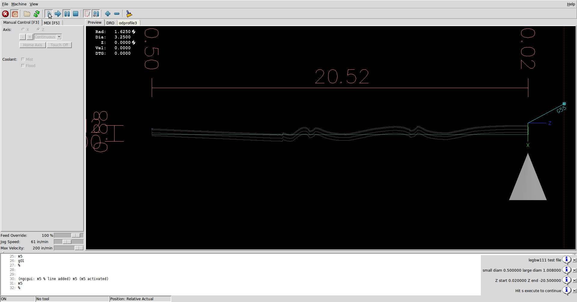

25 Jul 2013 17:59 - 25 Jul 2013 18:12 #37026
by Rick G
Replied by Rick G on topic Re:Lathe odprofile
Here is a newer version.
To calculate the number of cuts / passes the smallest diameter of the part and the material diameter must be known.
The material diameter may change depending on the stock used but the smallest diameter of the part should remain the same.
In the original the smallest diameter was input with ngcgui which means we need to know that diameter.
On a simple part with only a couple moves this is easy to find or maybe remember, but on a more complicated part it can be more difficult.
Also as the file name is now a number it is helpful to have some information or the original name of the file appear on the screen.
#<_TEST:SUB> is used to see if the sub has been edited for odprofile3, if not there is an intentionally bad move to error emc2 out.
The following is added to the beginning of the new subs:
(name of file)
(some descriptive information of the part)
#<_small:diam> = n where n is the smallest diameter of the part which will be used by odprofile3 for calculations
#<First_round> = #1 first call of sub to read #<_small:diam> #<_large:diam> #<_Z:start> #<_Z:end>then return to odprofile, remaining calls to run part.
#<_Z:start> = n Z location to start
#<_Z:end> = n Z end location
#<_TEST:SUB> = 1 variable to check if sub is set up for odprofile3
For example...
o<10> sub
(File 10.ngc)
(October 24, 2006)
(turning 10 legbw111 for lathe)
(sample code not for actual turning used only to demonstrate odprofile3)
#<First_round> = #1
; #<_small:diam> is smallest diameter of part, read by odprofile3 used to set number and depth of cuts
; #<_large:diam> is largest diameter of part
; #<_Z:start> is location for Z to start each cut at
; #<_Z:end> is end of Z cut
#<_small:diam> = .50
#<_large:diam> = 1.008
#<_Z:start> =.020
#<_Z:end> =-20.50
#<_TEST:SUB> = 1
o101 if [#<First_round> eq 1]
;give user some info on file
(MSG, legbw111 test file)
(debug, small diam #<_small:diam> large diam #<_large:diam>)
(debug,Z start #<_Z:start> Z end #<_Z:end>)
(print line: #<_small:diam> #<_large:diam> #<_Z:start> #<_Z:end>)
o100 return
o101 endif
; moves start here
lines of code
o<10> endsub
With this the description of the part and the small diameter, large diameter, Z start and Z end show on the screen and are followed by a M0 to give opportunity to review the information and proceed or cancel.
