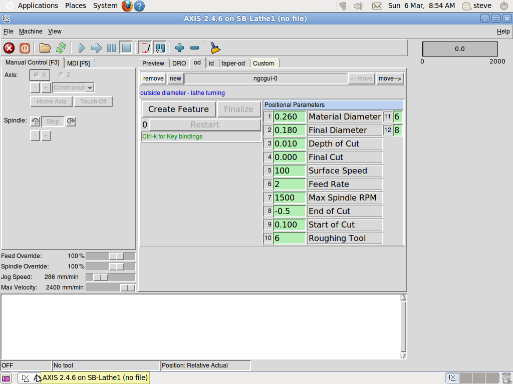

Trying to resize the ngcgui tab contents when embedded in axis without any sucess. Resizing the font doesn't work - one reason is the font defined in the files is helvetica, it's not in the fonts on 10.04? Tried renaming to to Sans - still nothing. Have changed all instances I can find in the ini and tcl files, but the font and the size stay the same :(
Any ideas where else to look?
Steve

Hi John - it's the font within the tabs - the tabs themselves are too big to fit everything in. For instance on the OD tab there are two positional parameters 11 & 12 - I can't see what they are.
Screen grab shows what I mean.

Hi John - the ini file contains
NGCGUI_FONT = Sans -8 normal
The default was
NGCGUI_FONT = Helvetica -10 normal
the font options does absolutely nothing here. I can change the font size or type in the ini file without any effect whatsoever?
I thought the problem was because there is no helvetica font in Ubuntu 10.04, so I changed it to Sans (which does exist) and that does nothing either.
Can't make axis wider, that's full screen :(
Steve
06 Mar 2011 10:27 #7608 by Pilotltd
Replied by Pilotltd on topic Re:Resize ngcgui tab contents in axis?
Got it - removing everything after NGCGUI_FONT =
works. That line has no option and now works - yipee :)
