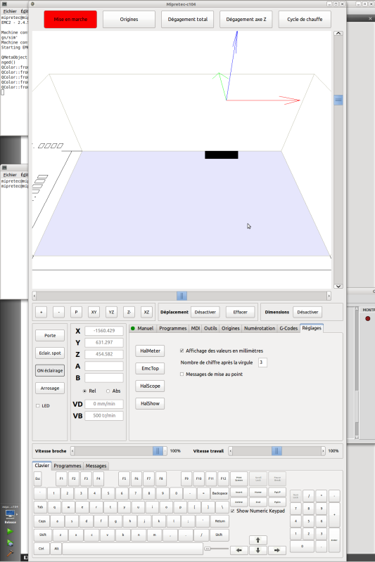

You have a screen shot?

screenshot of the interface?
Currently, only one interface development. The client interface will be operational in September / October, a very different arrangement.
The destination machine is visible on the site www.mipretec.ch.
The touch screen is 1920x1080 vertically.
Michel
