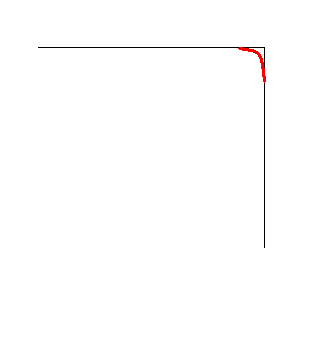

I have not see python/rs274 yet, so I don't know how it process the problem of traj after G41/G42 compensation, it is really a hard work to do by myself
The another problem is that after blend, would the controller's running traj exactly same with G code's traj?
Like the attach's pic, blak line is the G code traj, would the controller to run on the red line because of blend?

Replied by ArcEye on topic Some problems of building a new GUI by qt
You are right about blending of 2 straight lines unless you use absolute path /stop G61
Sometimes the only way to cut a proper square shape is to program a slight hash with the cuts overrunning the corners of the square.
Out of G61, the faster the feed the more the curvature, so you see it especially on rapid returns.

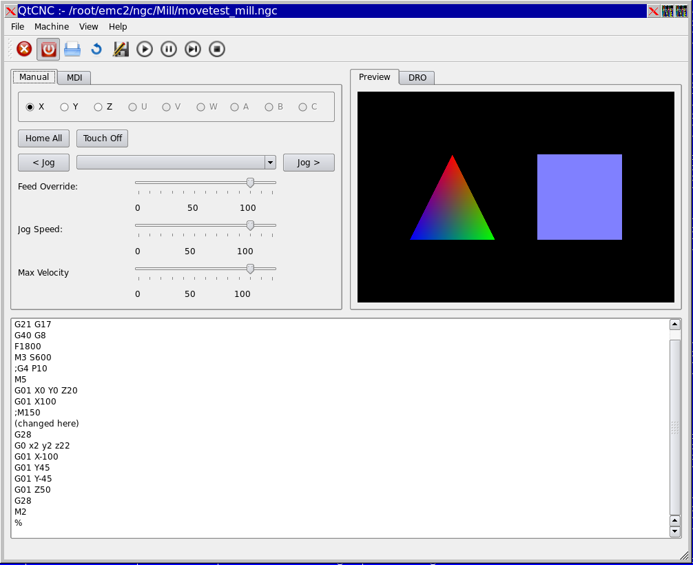

26 Nov 2012 22:07 #26958

- miaochengyu
- Posts: 3
27 Nov 2012 08:34 #26969
by miaochengyu
Replied by miaochengyu on topic Some problems of building a new GUI by qt
Nice work!
