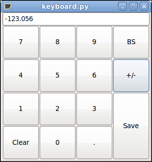

26 Nov 2012 20:15 - 26 Nov 2012 20:18 #26955 by BigJohnT
Replied by BigJohnT on topic Python Gtk NGCGUI
Ok I have a well behaved keyboard that I did in Glade. The plus/minus key toggles the sign, the BS key is a backspace key, the clear does what you think it should and the save does nothing at this point.
Now to try and figure out how to add it to a gui and send the result of the keyboard back to the entry widget. Any and all hints are appreciated.
John
Last edit: 26 Nov 2012 20:18 by BigJohnT.
27 Nov 2012 03:49 #26964 by cmorley
Replied by cmorley on topic Python Gtk NGCGUI
Put it in a dialog box.
have the entry boxes signal 'enter-notify-event' call a callback function that show this dialog.
The callback function automatically is sent the widget object (the entry widget) as the first argument.
When the keyboard function is done have it fill this entry widget with the data.
You may wish to use a different signal as the one I quoted will fire when ever the cursor goes over over the widget.
You may wish it to be over and click or have different behaviour depending if you have a touch screen or not.
Chris M

27 Nov 2012 05:50 #26966 by BigJohnT
Ok, just like showing a Help About dialog I assume. I was under the impression you could make separate screens but I'm guessing that is only to include in Glade.
John
27 Nov 2012 07:30 #26967 by cmorley
You could leave it as a separate window if you like.
a dialog is just convenient sometimes.
