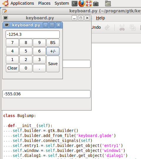

Hmmm, not having any luck. Can you take a peek at the python file and see if you spot anything? As it stands now the screen comes up blank.
John

One of the things that bugged me was to have so many functions... one for each button etc. But that is not needed... (slap to forehead). The widget is passed when you press a button or most anything else so just use that to know which widget you just got the signal from. For example I can have 25 data entry fields with unique names and I only need one function to use the keypad thingy with.
This is so much better than what I was trying to do before making a function for each key. Some keys with different actions will still have a separate function.
Onwards and forward... next I think is to create a subroutine tab and sort out how to send the generated file to LinuxCNC via the python interface program_open().
John
def on_entry_button_press_event(self, widget, data=None):
self.current_entry = widget
self.response = self.dialog1.run()
def on_kb_clicked(self, widget, data=None):
self.current = self.num_entry.get_text()
self.current = self.current + widget.get_label()
self.num_entry.set_text(self.current)
def on_kb_save_clicked(self, widget, data=None):
self.current_entry.set_text(self.num_entry.get_text())
self.num_entry.set_text('')
self.dialog1.hide()
