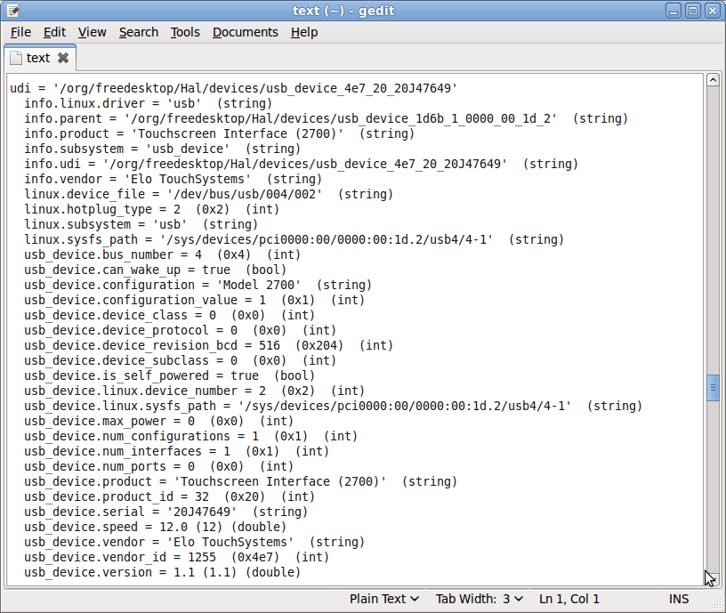

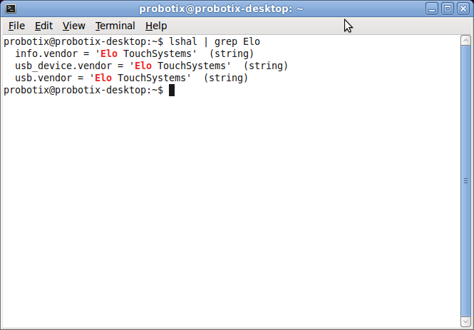

01 May 2013 21:35 #33489
by beltramidave
Replied by beltramidave on topic Touch screen setup GUI
Thanks John,
That is the exact model that I have. If I unplug my serial cable, I lose my signal and the screen will go blank. I had thought when I originally installed this TP that I did not need the serial cable, but the only way I could get it to work was to plug both cables in.
This morning I was able to install the conf file (and modified it to be exactly like yours) and made sure that it was owned by root. I then rebooted the computer and repowered the TP and everything came back working as normal...whew! I have attached 2 files showing the results of 1. lshal | grep Elo and 2. sudo lshal > text gedit text. I still do not see the info or input product information as you have and I also don't see input.device in the text file.
At this point I am not sure if everything is working or not, nothing seems to be any different. Seems like a stupid question, but how do you go about calibrating and setting up the TP using evtouch?

01 May 2013 21:47 #33490
by BigJohnT
Replied by BigJohnT on topic Touch screen setup GUI
At this point I would contact Elo tech support. It should work with USB alone and your not getting the proper reply from lshal | grep Elo.
Have you tried the USB cable only since you corrected the config file? Are you sure the USB cable is plugged all the way in at the monitor?
Do you think by having the serial cable plugged in that some driver was installed that hosed something up?
John
John

01 May 2013 22:41 #33492
by BigJohnT
Just a quick thought try a different USB port on your computer and see if you get the proper response from lshal | grep Elo.
