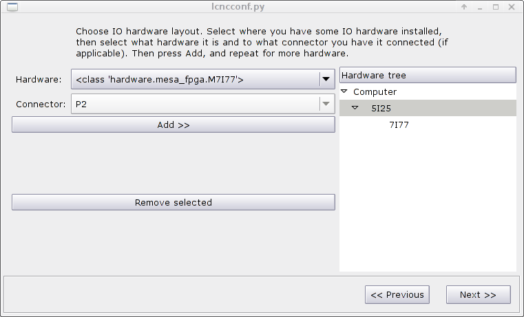

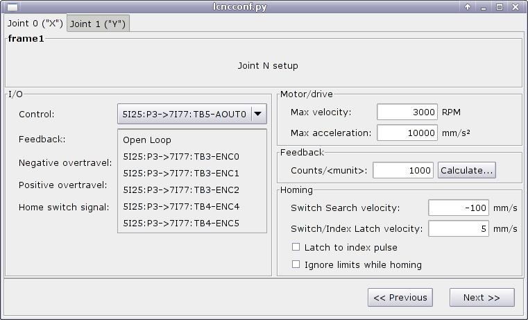

Ok, so I'm slowly getting somewhere:
Hardware selection:
Joint configuration:
And this would generate a config something like this (but aligned - weird that the code tag doesn't use a monospaced font? Oh, it's just the preview that doesn't show the code section properly...):
These are actual outputs from the program, but the HAL generation was an earlier experiment and I haven't gotten it integrated with the main program yet. Glade/gtk is quite complicated, and it takes time to get where I want! Although I guess I'm getting more familiar with it all the time.
As you can see the program is a complete redesign, although very much inspired by pncconf. Actually, there's no reason why this program could only handle Mesa hardware...

Looking pretty good.
I would name it something snappy like: machine builder.
In your hardware tree how will you select which connector the 7i77 is on? If there are optional sserial boards how will you select which sserial channels they are on?
Will you allow deselection of components to free up GPIO?
Forgive me if I am getting ahead of you - I understand WIP.
One thing I always wanted was to have sane defaults for imperial and metric units. PNCconf just converts the imperial units and it doesn't always make sense. Something to keep in mind.
Even nicer if you could switch units per page - sometimes metric units are used on an other wise imperial machine.
I like the single signal / pin per line - nice and clean.
I would add a checkbox to invert the index direction and latch style.
and on a linear axis max velocity is usually shown in mm/min
Chris M
Chris M
