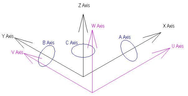

- tjamscad
- Posts: 320
11 Jul 2013 19:22 #36552
by tjamscad
Replied by tjamscad on topic Best GUI for touch and 4th axis
We have machines that have multi axis's. We have 3 horzintal machines that have 4 axis's X,Y,Z and B. We also have a horzintal boreing mill that 4 axis's X,Y,Z and W. We have 1 vertical mill that has 5 axis X,Y,Z,A and B. We large gantry type 5 axis that uses X,Y,Z,B and C axis. We have a wire EDM that is 5 axis but it uses X,Y,Z, U and V. Here is a good refference for how the axis's all work together.
