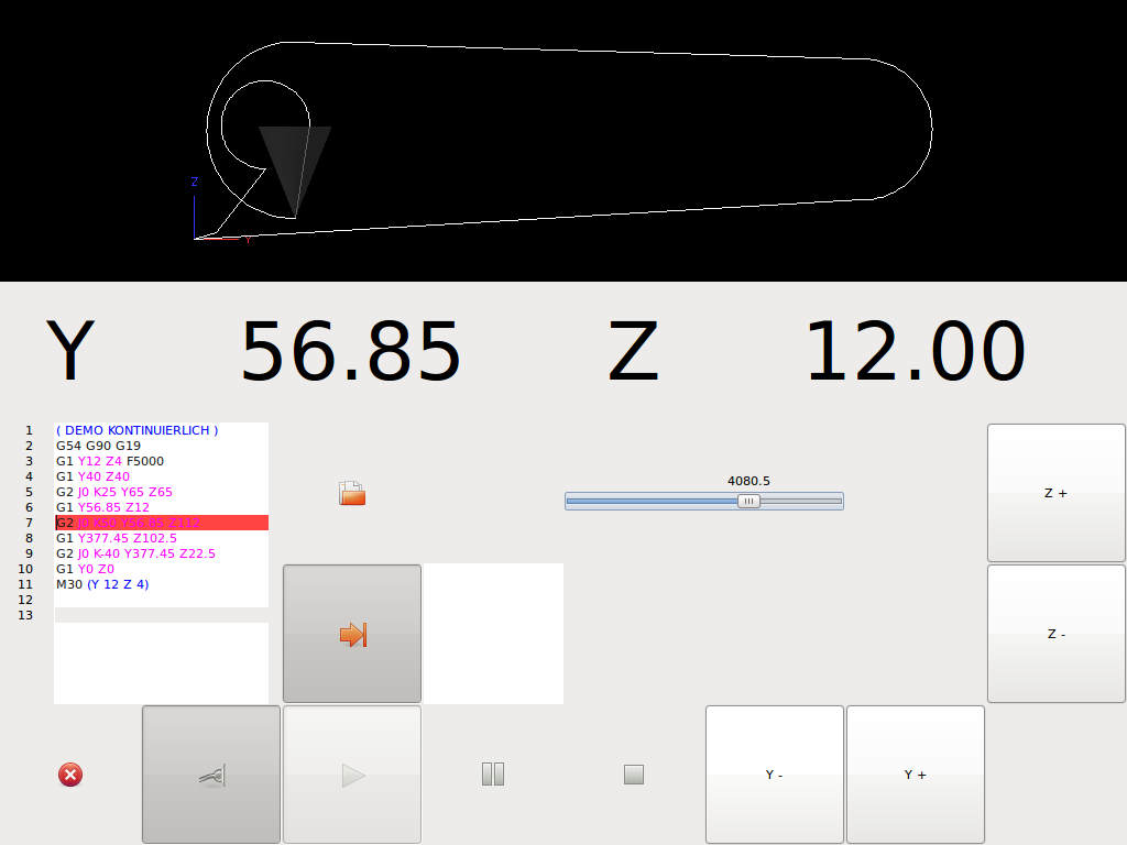

Andi's useful hint about nice MPG - just now I've seen his impressive work on Glade LatheMacro - really amazing
color combination in "EMC_SourceView" is not so accurate
how can we define colour properties in Glade e.g. ?
<object class="EMC_SourceView" id="hal_sourceview1">
<property name="visible">True</property>
<property name="can_focus">True</property>
<property name="left_margin">2</property>
<property name="right_margin">2</property>
<property name="show_line_numbers">True</property>
<property name="show_line_marks">True</property>
<property name="tab_width">4</property>
<property name="auto_indent">True</property>
<property name="highlight_current_line">True</property>
<property name="indent_on_tab">False</property>
</object>
</object>

Andy, I think that, too. May I repeat here my question concerning YZPoson.png

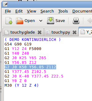

I am not sure I completely understand the question, but if you are talking about source-highlighting, how does your version of gedit look when viewing G-code?
The default sourceview that arrives with LinuxCNC doesn't work very well, there is a rather better one here:
cnc-club.ru/forum/viewtopic.php?f=33&t=80&p=27169
Replied by andypugh on topic touchy
talking about color combination in "EMC_SourceView" - the font for complete G-code is any purple and the highlighted line, marking the actually runned cycle also in any red colour is not so accurate
</object>
</object>
