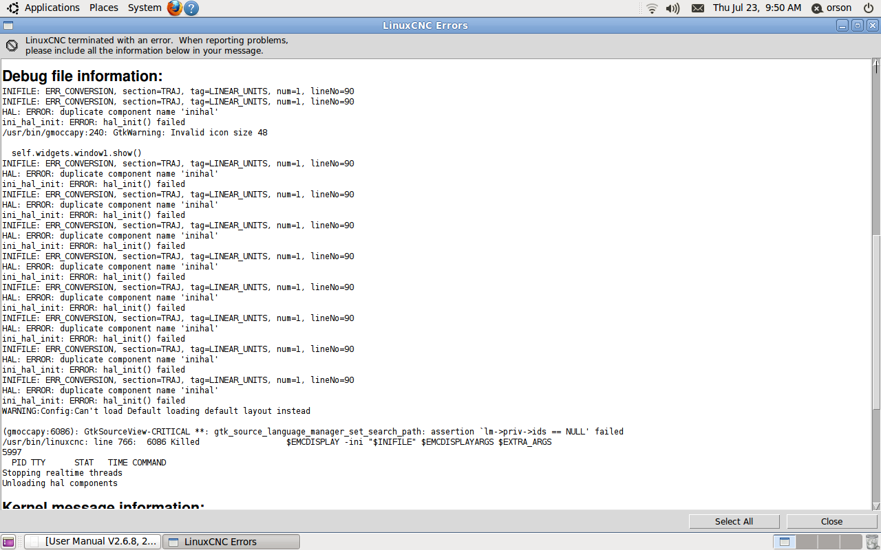

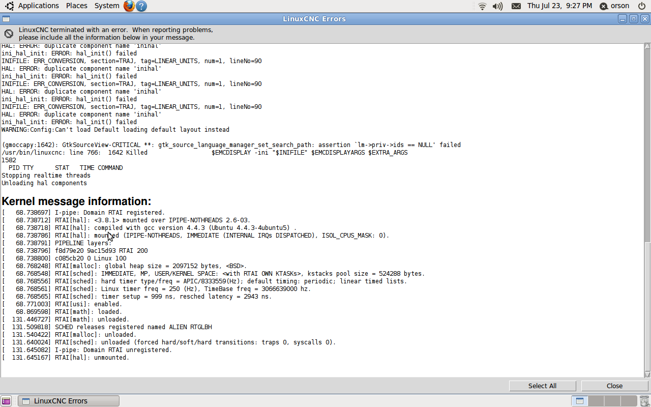

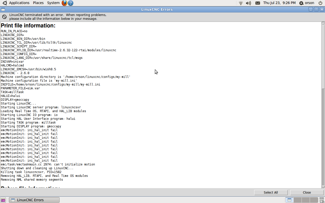

I read the user manual again and found Touchy requires hardware that I don't have yet so I decided to try gmoccapy. I tried to copy and paste the config files to my current machine set up and it tries to load but stops the screen goes dim and nothing happens I close the program and message screen shows up that gmoccapy has stopped responding and I have to force it to close. When it closes I get an error message screen that says a bunch of stuff that I don't understand that's why I have included it along with the gmoccapy.ini file from the current set up that I am trying to use.
If anyone can make sense of it and help me out awesome.

There seems to be a serious problem, because there is a double ini_hal.
Is there another hal application running?
Norbert
Norbert

I deleted all the files and started over and now it works except there is output to the machine.
