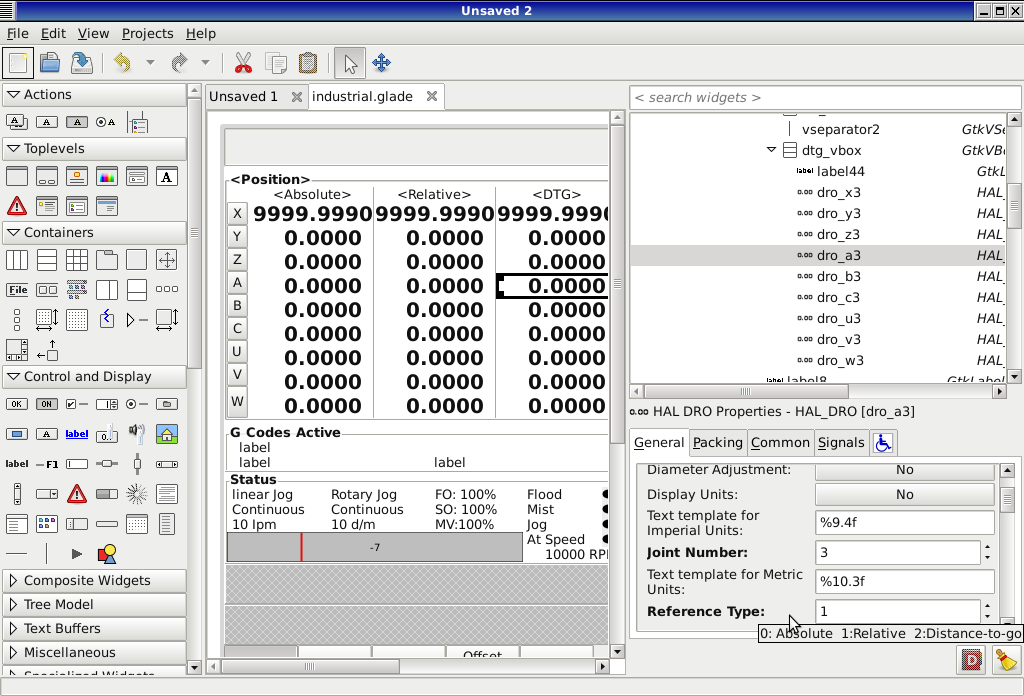

Finally got our 4th axis running on out machine and realized that the DTG column for the A axis is showing the actual position, not the distance to go.
Any thoughts?

ok I see the error, it's in the glade file.
if you load the glade file for industrial and click on the HAL_DRO dto for the a axis,
reference type should be 2 not 1 (on the properties side bar on the right)
then resave. - an update of linuxcnc will over write this fix.
If you save the glade file in your config folder the change will be permanent.
That will fix it for now I will push the fix on the weekend.
Let me know of anything else that could be better or fixed.
Chris M

Hey chris,
I can't find in the glade file the "hal_dro dtg" for the a axis, I searched for "hal_dro" in the search box, and can't come up with anything.
I opened the industrial.glade file, from the terminal too.
Rick
Rick

Replied by cmorley on topic Gscreen 4th axis DTG wrong
You must open the glade file with glade-gtk2 (version should be 3.8 something)

I have pushed the fix to this in 2.6, 2.7 and master, in which case just update and all should be good.
