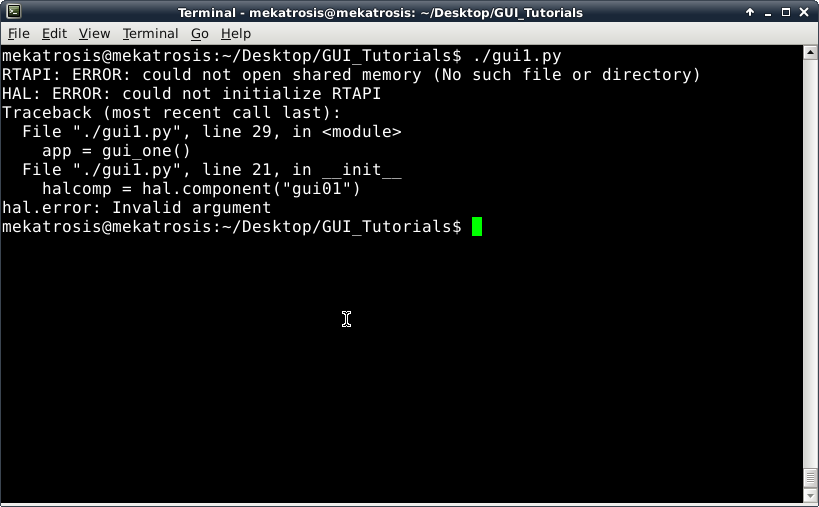

Hi to all...
I am trying to learn how to build a custom GUI from gnipsel's lessons.
But on the first tutor, there is a fault. I am using it's original files but it didnt work.
Here is the lesson :
Custom GUI Tutorial Part 1b
Here is the original code :
And here is my fault :
Can anyone help me ?

Are you running the real time kernel? Type uname -r in a terminal and see what it says.

28 May 2016 07:38 #75181
by bladekel
I ran the code that you have written, and the output is :
3.4-9-rtai-686-pae
Replied by bladekel on topic Failure on Gnipsel's Custom GUI Tutorial ?
Hi dude,Are you running the real time kernel? Type uname -r in a terminal and see what it says.
JT
3.4-9-rtai-686-pae

I just downloaded the two files from my website and started an Axis sim then executed the gui1.py file with no errors on the 3.4-9-rtai-686-pae kernel. I can only reproduce your error when I don't follow the instructions in the tutorial...

So what is your opinion, why am i getting that error ?
I didnt do anything else, only downloaded those files and ran the .py file.
I also get this error by the gui2.py ....
Replied by bladekel on topic You gotta follow the instructions!
I just downloaded the two files from my website and started Axis then executed the gui1.py file with no errors on the 3.4-9-rtai-686-pae kernel. I can only reproduce your error when I don't follow the instructions in the tutorial...
JT

It's plain and simple you didn't follow the instructions in the tutorial nor did you read my reply.

Hi John.
As you sad before I missed the part "running axis before new GUI" .
Everything works now.
Thanks for your tutorial and help .....
