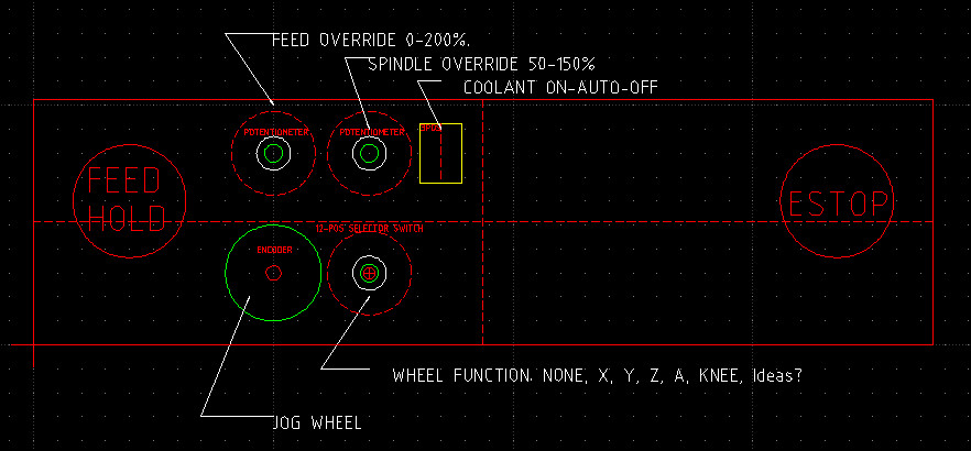

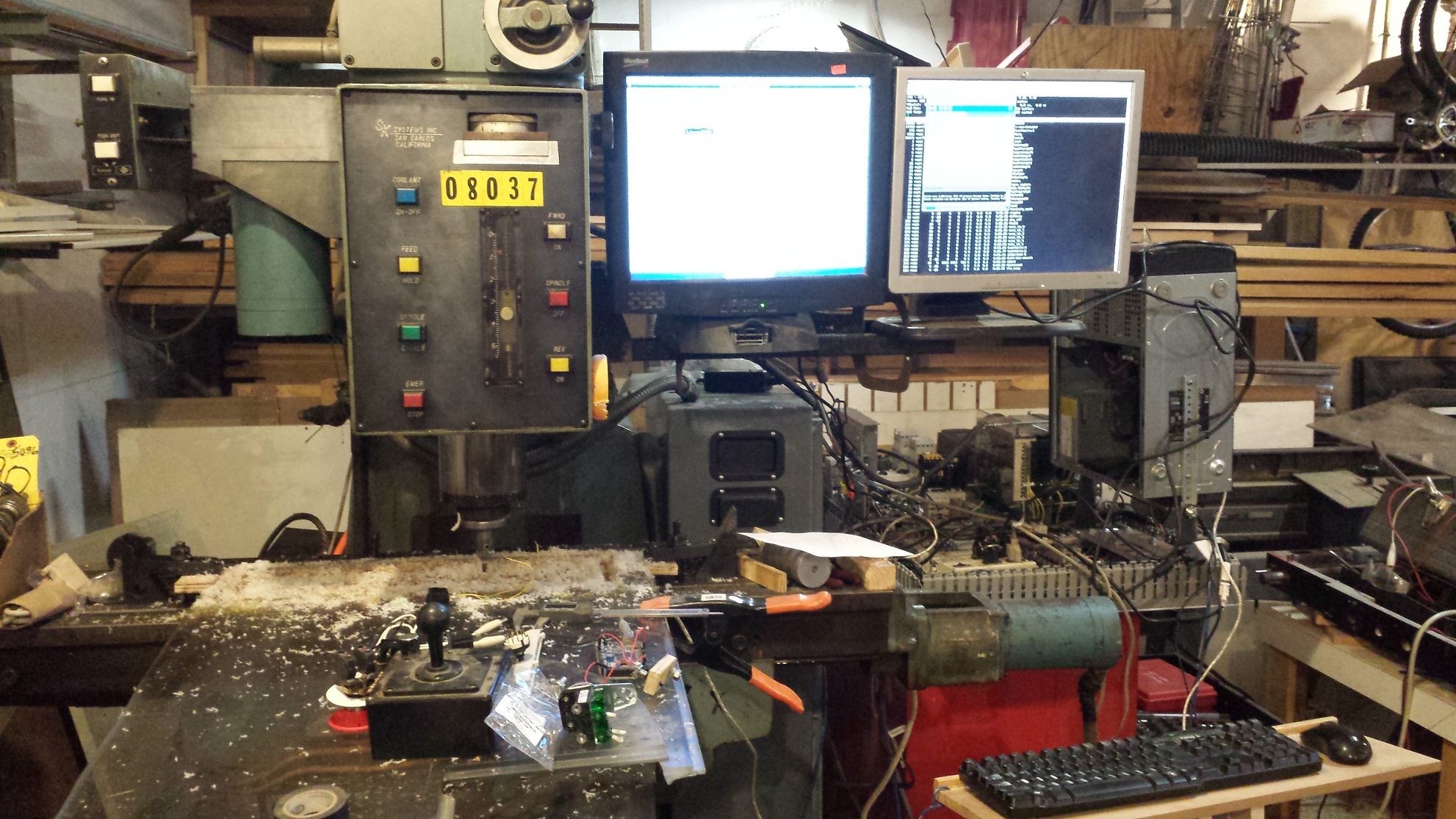

I would really love to get some feedback on the use of this proposed control panel layout This is going on my Shizuoka AN-S knee mill. The last attachment is a screenshot of the CAD, the first is a picture of the mill in progress. This button panel will be going under my two monitors just to the right of the head. The control panel is 5.5" high and 19.5" wide. I plan to keep using a keyboard, trackball, gamepad or pendant, and this physical control panel. My keyboard/mouse are on a "music stand." The e-stop button will be hard wired back to interrupt the estop relay. The pause/hold and the rest of the controls are going into an arduino in the control box that mb2hal will talk to over the USB cable. I've demonstrated the jogwheel has good feel at the ~20Hz update rate I can maintain with mb2hal. The 12pos switch will pick the wheel function (x,y,z,a, knee and other ideas are welcome). Is there a good reason for a hard-wired cycle start? I will also have a disconnect inline with the VFD/motor to prevent spindle movement while changing tools.

Hi k-1, Thank you for taking time to help me with my machine. What did you think about the attached picture of the proposed user interface panel? Any obviously needed hardware buttons missing?
When I read your reply, I was a little confused by what you meant with:
rtai response for your security?? apart from this you can connect it to Arduino ...
I agree that using software for one's security is not good practice, and I try whenever possible to make sure that software is not responsible for my safety. On the topic of a hardware start button, it would still go into an input to LinuxCNC, just like the GUI goes into LinuxCNC, so I am struggling to see how they are different. In both cases, LinuxCNC is responsible to manage when the machine starts, which I think is where the danger can come from. It has me thinking now about how I can keep the table from moving when I need to get my head/body in closer to the workpiece for setup while jogging the table. Maybe a big block of wood between the table and the frame? Your update rates are impressive. I think the 19200 baud drive must be holding up the show for my other transactions, or maybe my PC is too whimpy. Core 2 Duo, 3Ghz.

09 Feb 2017 15:50 #87709 by tommylight
Replied by tommylight on topic Physical Control Panel Feedback Wanted
Took me a while to find the machine in that picture ! :)
JT just posted a link to exactly what you need, minus the jog, plenty of jog related stuff in this forum.
forum.linuxcnc.org/24-hal-components/323...gle2nist-description
At the end is the link.

It is true talent to be able to camouflage a 3 ton machine!

09 Feb 2017 18:16 #87733 by tommylight
Well a touch screen with gmoccapy would solve that nicely.
I always use Axis as a front end for Linuxcnc, keyboard and mouse, nothing more or less. I got used to it so i do not need panels. When retrofiting, i tend to make only useful stuff to work, usualy as they were with feedback to Linuxcnc so it can know if something on the panel is pressed. That is about it.
I can see the start/stop/pause as very useful for sure, also a spindle on and spindle speed is nice to have, and a feed overide pot . Anything beyond that, i can not think of.
On big machines that move a lot of mass, i tend to put 2 limit switches at each end, 1 as a usual limit to Linuxcnc and the outer most as extreeme limits that cut power to drives and spindle or torch. For that i put a momentary switch to override extreeme limits after inspection. On older machines that is a must, i had a case lately where the encoder connector was faulty and the X motor just took off till it hit that extreeme limit. That is a nice feature to have especialy when using closed loop servo drives where the loop is closed in the drive. In the case of loop being closed in Linuxcnc, it will just fault with the mesage joint.N following error and stop the drives.

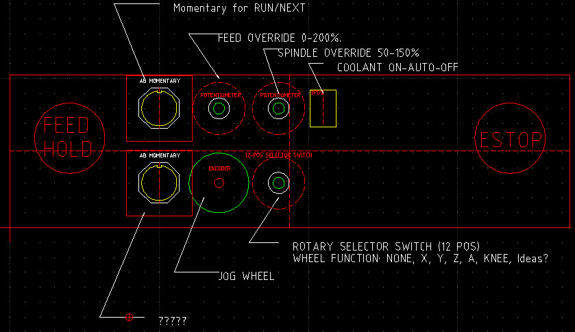

09 Feb 2017 21:35 - 09 Feb 2017 21:45 #87743 by yeltrow
Replied by yeltrow on topic Physical Control Panel Feedback Wanted
Excellent thoughts on the "inform" vs "emergency" limit switches and the override. Servos can get a mind of their own in a way a stepper machine can only dream of.
Based on the feedback I have received thus far I have modified my control panel layout as shown in the attached jpg.
My interface is primarily to save humans, the machine, parts, and then consumables. The Axis interface and the others are very complete.
My rank order has been:
E-Stop, because STUFF happens (especially when developing a machine).
Pause - because I will make programming mistakes and realize it just 1/2 second before it goes wrong
[ I was going to make the pause button a latching e-stop painted yellow or blue -- Should it be momentary? ]
Feed Override - Because I made an estimate in programming that didn't pan out
Spindle Override - Same reason
Coolant - I figured that if I forgot coolant or was getting a bath, I would want that to change fast
Jogwheel (Could save that for the MPG, but I can imagine it will save a lot of setup time if I can reach it and see at the same time) Maybe I should save this for the pendant.
Speed Selector - Same
Nice to have:
Run/Next sounds really useful. It seems like it should be directly next to the big pause button. It also seems reasonable to save for the pendant or keyboard.
Last edit: 09 Feb 2017 21:45 by yeltrow.

09 Feb 2017 23:30 #87745 by tommylight
On thebrotary switch you have "none,x,y,z, etc etc ideas". I would add FOOD to those ideas if possible ! :)

on ideas you can connect a special mdi command for ex. press one button and select specialone run halui.mdi0, select specialone and press buttontwo run halui.mdi1, select specialtwo or FOOD if you want ... (where I am, among technicians, when you see a new beautiful built machine / robot often saidl: ok but can make spaghetti? :laugh: )....
