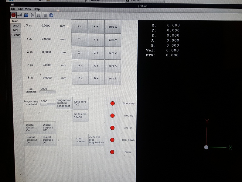

Hi Andy,
Thank you for this. I have done the Stepconf Wizard to import a Mach.xml config file. I see the pitch is displayed conform the Mach settings. So this is nice to know.
The test screen i made is working, but the led's are stil a problem. Maybe later i find out how to do this. I think it has to do with the stand alone application configuration. If i set output 1, then i want to turn on a control led on the screen. I think i know that in a linux configuration with side plugin panel, it works simpeler.
So in this stadium i connected the complete parport pins configuration as i use normally. I made a seperate hal file only to set the parport pins. This looks structural to me.
Now i was studying Gmocappy. The screen is nice to study. How they did everything. This glade file won't start up if my linuxcnc is not running. Strange. I did a Linux update yesterday. Before that everything was starting up good. And a update restore was not working for my pc. But it's working.

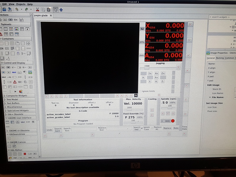

Now the big question for me is as follows. Gmocappy load's a python code to handle all the signals of the glade main screen.
Okey, so i was searching for this python file.
Then i come out by : remap.py / stdgleu.py / toplevel.py
In the toplevel.py is a short code, but not for the main screen buttons.
I think it has some thing to do with : from interpreter import *
Does somebody know where the python file is located for the main screen of Gmocappy? Then i can maybe fix my
next problem's. I want to do the zoom in and zoom out and the screen clear buttons and signals.

Replied by rodw on topic Introduce myself and a queston for Setting OUTPUT 17
You should find the gmocappy source (.py and .glade) in
/src/emc/usr_intf/gmoccapy/
if you have compiled linuxcnc from source then that should be in
~/linuxcnc-dev/src/emc/usr_intf/gmoccapy/
I think in a working system its in the bin folder

A update about my Linux experience.
I have the problem i can't connect a glade led to my proma thc.
I have made a stand alone gui. see the tutorials of John Thornton how to do this.
I find out updating of Linux is not good to do. So i have a clean Linux version without updating. Just put in the iso file cd again.
There is a problem with accessing the root directory after updating. I think limited administration rights or so, this problem is active after updating. So your stand alone gui work's not anymore. This sheep was crying. HIHI.
But in mean time i have running my cnc interface board. My external pci card works on the pci adress. the output's are working. So good to hear some relais clicking.
But at the imput side, i see nothing happening on my glade led's.
The thc toma configuration is i think the most simple one to ingegrate in the glade process. But first i must make some imput led's working.
If i attach configuration files, someone can help me?

10 Jul 2017 18:14 #95628
If you run halshow, can you see the pin you have made with Glade?
If not, you have a software error in glade.
Can you see the physical breakout board pin changing state in halshow?
If you have got that for, it will just be a matter of adding some lines in you hal file something like
net my-proma-input <= the-bob-input-pin
net my-proma-input => my-glade-led
