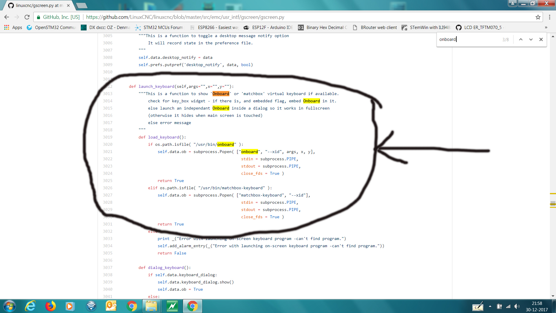

Hi
just found something in gscreen.py ...see attachement..
can i just change that ?
Hjalmar
Hjalmar
- Posts: 7368
- Thank you received: 2181
30 Dec 2017 22:43 - 30 Dec 2017 22:54 #103880
Replied by cmorley on topic Gscreen - florence instead of onboard
Yes that is the place. I am not familiar with florence keyboard, so I'm not sure if there are more details required.
But it's pretty easy to try...
Gmoccapy allows the use of matchbox-keyboard - Gscreen was never updated for it, so that is a possibility too.
I see you are using master so can use matchbox-keyboard already if you can install it on the system.
sudo apt install matchbox-keyboard
Though if you do get florence to work please post the code and i'll add it to gscreen
Chris M

31 Dec 2017 07:58 #103890
by Skovholm
Replied by Skovholm on topic Gscreen - florence instead of onboard
HI Chris
Thanks for looking into this...
I installed matchbox-keyboard and can run it if i in a terminal write /usr/bin/matchbox-keyboard
BUT the button on gscreen will not activate it ...
What can the problem be ? ...permissions seem to be ok but are that an issue ?
if i want to use florence i need to recompile the hole thing and i dont want to go into that
appriciate your help..
Hjalmar

02 Jan 2018 03:41 #103942
I'm not sure what the problem could be - it works for me - i'm using Mint though.
does it work in terminal with just 'matchbox-keyboard' ?
You don't have to recompile, you just need to modify the copied version (if it's an installed version)
Chris M
Chris M

02 Jan 2018 08:06 #103945
I looked at Florence - coded an example but it doesn't work quite the same as the other two.
it would take much more work to make it work properly.
I will not be presueing it.
Sorry
Chris M
