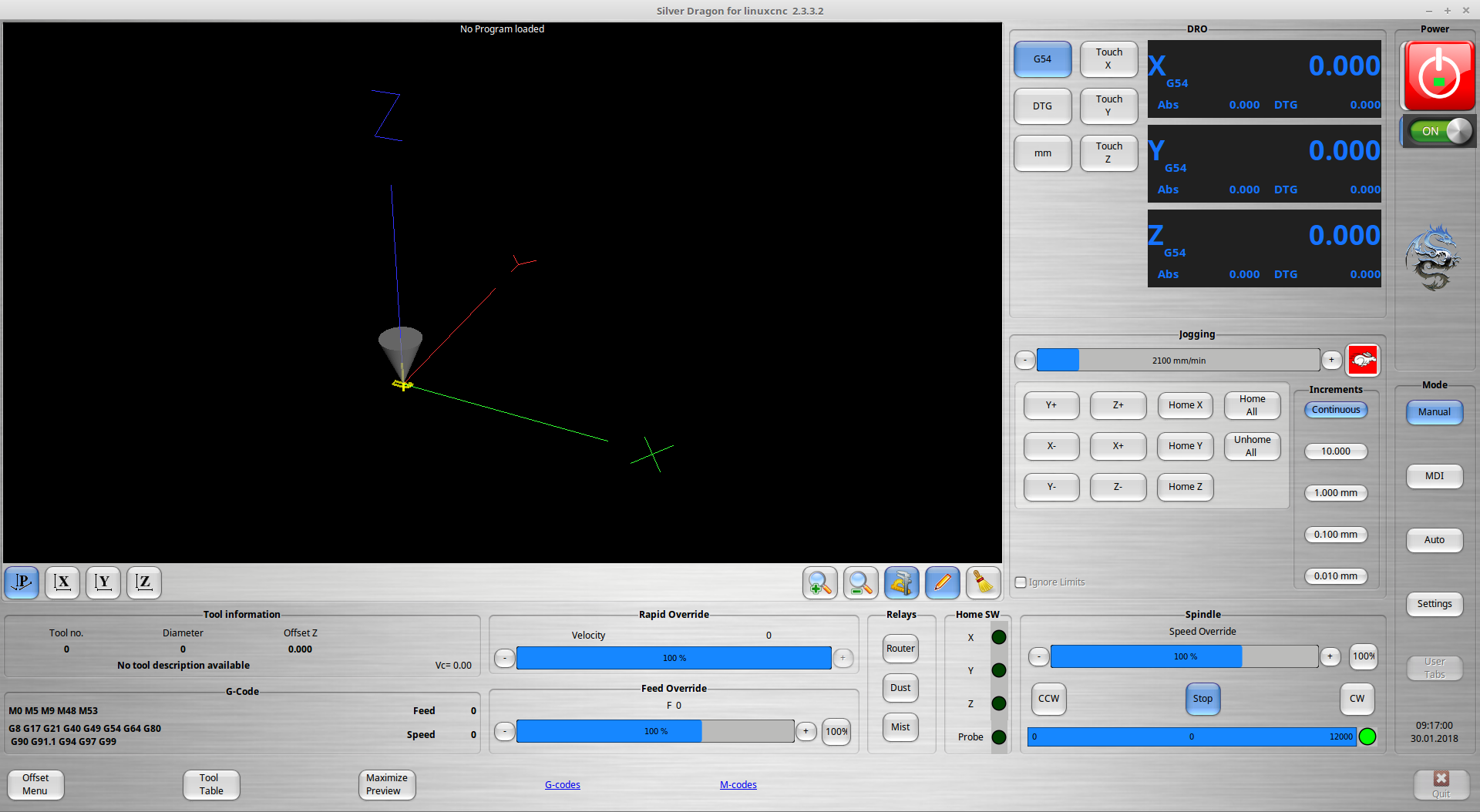

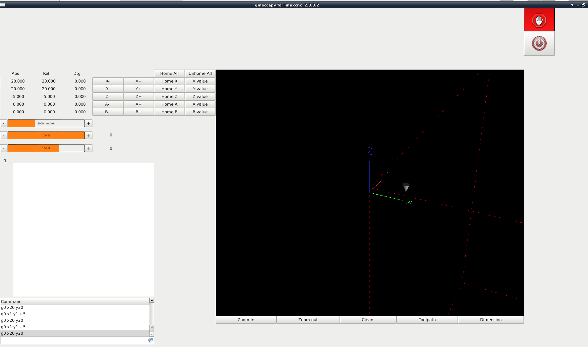

I want to know the opinion of the linuxcnc users and software developpers about a tested custom screen test i did today.
I have a gmoccapy screen loaded and tested without errors. It's bases on the full orginal code.
My problem was to make a custom screen specally for my machine's. So weeks and weeks i am trying to build something with
glade and python. Now i have found a way today to make a custom screen in minutes based on the orginal code, without errors.
This not possible for the axis screen. But possible for all the glade designed screen's.
I think i found a trick to do it. But maybe the programmer say : i did know that for 10 years.....
This is not done by replacing the screen in ini file. with -

I just went through the same exercise over the last week and concluded that building a custom panel from scratch was not going to happen. As Chris said, "It takes a lot of experience to make a full featured screen." and he is absolutely correct. What I did manage to do was create a custom screen for my DIY router based on the gmoccapy glade file. This involved minimal hacking on the python code. So, I think your idea of building a custom screen from the gmoccapy base is completely viable.

Today I was trying to input more buttons and things.
I had to change a few little things in the python file, but was easy to do, i have little experience now.
The g-code view field is by startup not visible, so that are tiny things, that must be changed if you use different layout.
So in the code you set it to "True" with comment's what you have done in the most left area, so you can see directly what is changed.

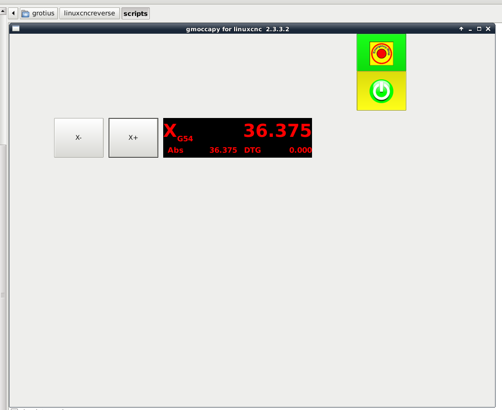

I made a new window in the same project and renamed the orginal window. So i can cut and paste. or sometimes is handy to
make a new button with the orginal handler name. At this moment i thing i need a I7 processor.

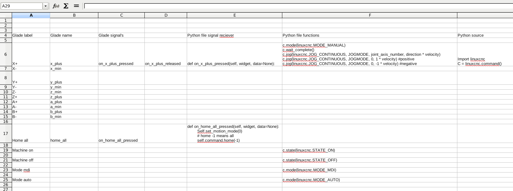

I had also an idea to make a public button library for all command's that are releated to each other. So you can see easely
how things are working together.
I made a start with a simple button command list.
I think it can be handy for many users. I can share it on google drive. And it can be updated by others too if you use a share function to the file.

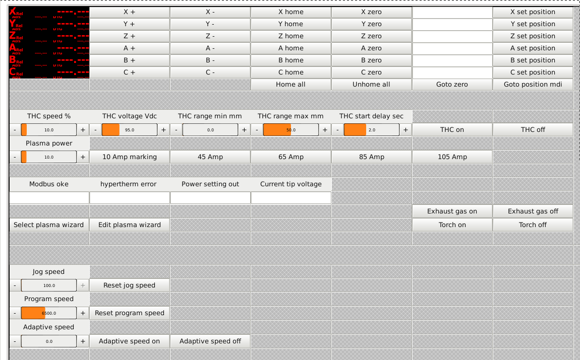

Update of my blanco glade screen design tonight.
It's just like making a birthday list. Hihi
