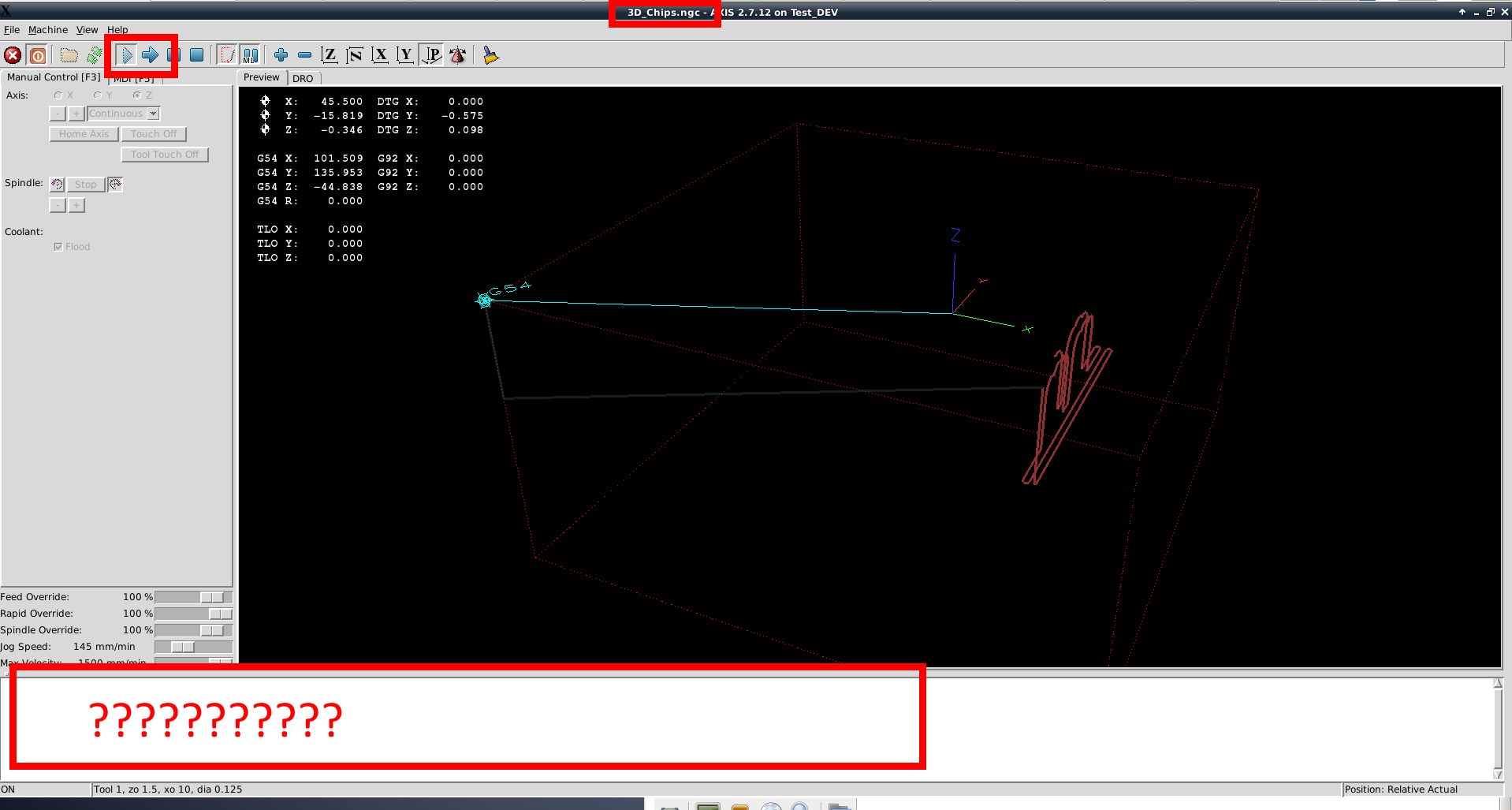

It seems like the file is opening
l.mode(linuxcnc.MODE_MDI)
l.program_open("/home/cnc/Desktop/donno_external_arduino/3D_Chips.ngc")
os.system("axis-remote --reload ")
l.mode(linuxcnc.MODE_MANUAL)
I can even run the file but there is no g-code displayed, no g-code drawing
The image shows that is is running g-code program
Any way to display it on screen and lines being executed ?

If I press o [Shortcut Key] it opens correctly but if open it through Python program_open() then it does that ! I have even os.system("axis-remote --reload ") but still the same. I edit file and program_open it and run g-code still same but new file executes must be a BUG

I think you need to use "axis-remote" to load your file, instead of "program_open".

I can't say exactly how you would use it in python, but from the command line, the command is just "axis-remote filename". For example to open the 3D-Chips.ngc file on my test machine, the command is.
axis-remote ~/linuxcnc/nc_files/examples/3D_Chips.ngcPlease Log in or Create an account to join the conversation.

instead of usinguse
c.program_open("foo.ngc")os.system ("axis-remote foo.ngc")
