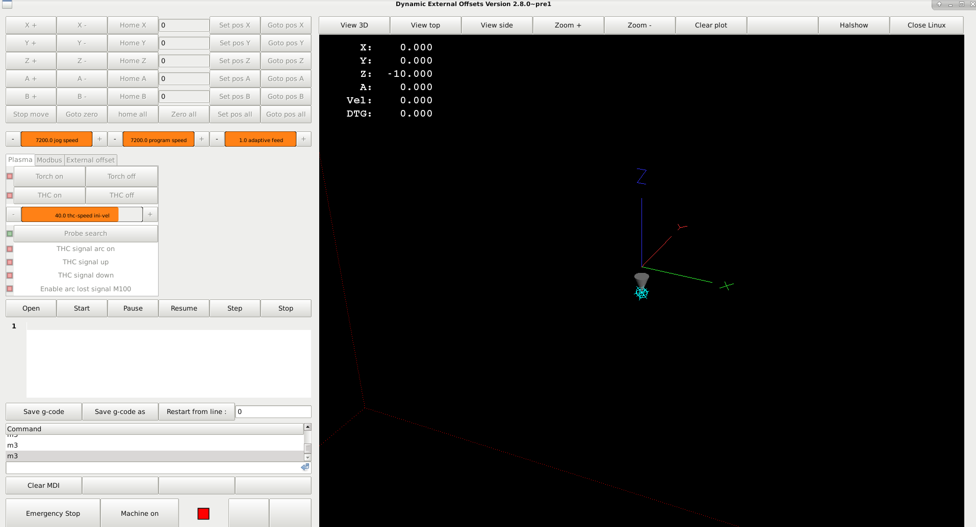

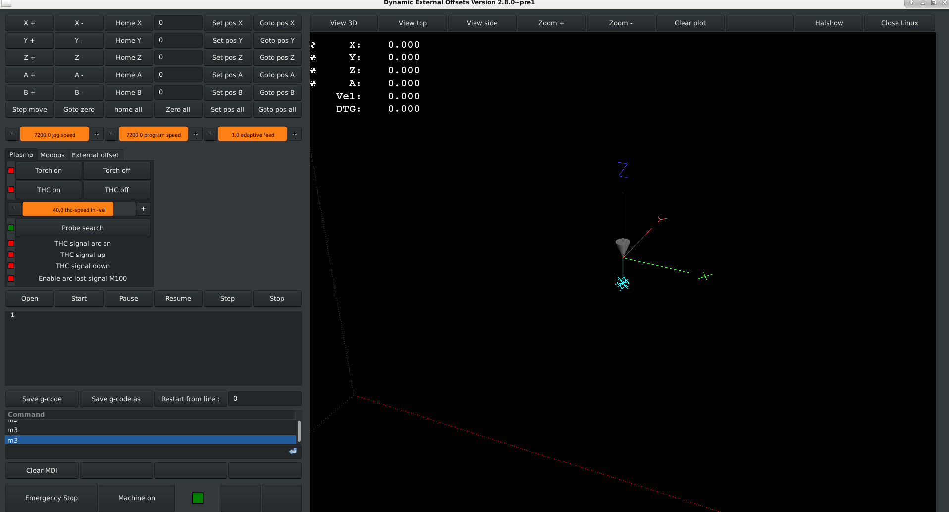

Programmer info: Change system theme color into dark with 3 lines of python code was created by Grotius
Example normal system theme colors :
Example after 3 lines of code :

In Gscreen this code is for changing system theme, Gmoccapy uses almost the same code :
import gtk
self.settings = gtk.settings_get_default()
self.settings.set_property("gtk-theme-name", "Adwaita-dark")Example after 3 lines of code :

Replied by cmorley on topic Programmer info: Change system theme color into dark with 3 lines of python code
This is because Gscreen and Gmoccapy allow you to have your special theme in the config folder rather then the system folder.
Some CNC themes are not suitable for the system.
