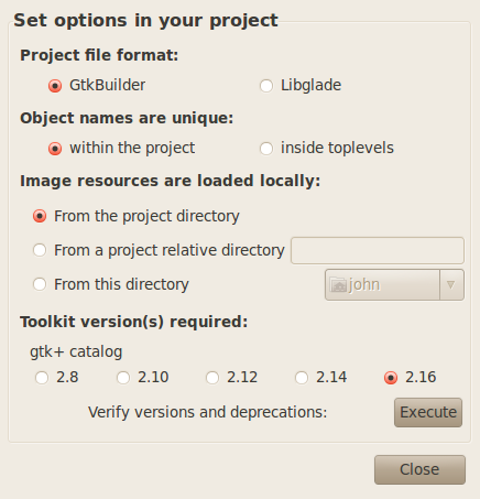

Following a post on the mailing list where Chris M said he could use Glade to add to a GUI like Touchy I promptly installed Glade. The first thing I ran up against was on running the Glade Interface Designer was a bunch of choices that were not very intuitive. Any suggestions on what these choices mean?
John

Replied by cmorley on topic Re:Using Glade to Make a GUI
Yes all EMC's glade file use LibGlade - check it.
ignore the rest. and close it.
If you load a large project like pncconf unless your computer is fast it can take
a l o n g time.
emc's glade files are in src/emc/usr_intf/
the pick touch/ or pncconf/ etc
