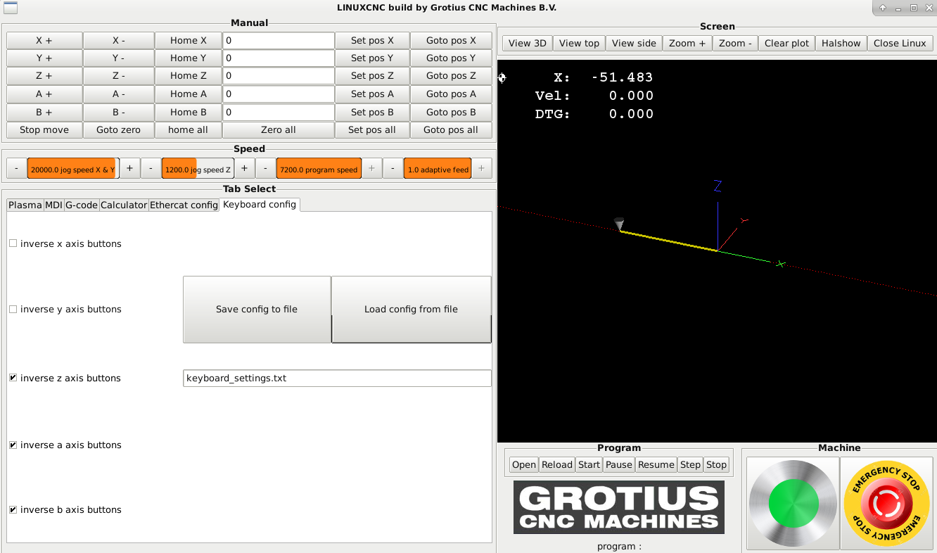

For the coming up generation of linuxcnc interfaces it is handy to invert keyboard jog buttons at any time.
Mach3 has such a keyboard configuration option in their config directory.
Frequently users have different console position's related to their machine position. Keyboard jog button's (button arrows)
are more understandable if they are aligned with machine movement's.
This example is intended for more experienced linuxcnc users that have some experience with custum gui programming.
How to implement :
In the keycall function for each axis in user gui i added a inverse direction :
I added for each axis checkboxes in glade, named "inverse_x" checkbox for x axis.
It writes a configuration text file, and it load's the configuration file also on startup in a slow periodic thread.
It works fantastic !!
For checking the keyboard config file i added a slow thread every 2 second's.
gobject.timeout_add(2000, self.slow_periodic)
def on_keycall_XNEG(self,state,SHIFT,CNTRL,ALT):
if state == 1 and self.widgets.inverse_x.get_active():
self.on_x_min_pressed(state)
return True
if state == 0 and self.widgets.inverse_x.get_active():
self.on_x_min_released(state)
return True
#inverse direction :
if state == 1 and not self.widgets.inverse_x.get_active():
self.on_x_plus_pressed(state)
return True
if state == 0 and not self.widgets.inverse_x.get_active():
self.on_x_plus_released(state)
return TrueI added for each axis checkboxes in glade, named "inverse_x" checkbox for x axis.
def on_save_settings_as_pressed(self, widget, data=None):
value_x = self.widgets.inverse_x.get_active()
value_y = self.widgets.inverse_y.get_active()
value_z = self.widgets.inverse_z.get_active()
value_a = self.widgets.inverse_a.get_active()
value_b = self.widgets.inverse_b.get_active()
x = self.widgets.filename_entry.get_text()
f=open(x, "w+")
f.write("inverse_x\r\n")
f.write("%d\r\n" % (value_x))
f.write("inverse_y\r\n")
f.write("%d\r\n" % (value_y))
f.write("inverse_z\r\n")
f.write("%d\r\n" % (value_z))
f.write("inverse_a\r\n")
f.write("%d\r\n" % (value_a))
f.write("inverse_b\r\n")
f.write("%d\r\n" % (value_b))
f.close()
def on_load_settings_pressed(self, widget, data=None):
f=open(x, "r")
if f.mode == 'r':
content =f.readlines()
value_x = int(content[1])
self.widgets.inverse_x.set_active(value_x)
#content[1] # actual line 2 in file.
value_y = int(content[3])
self.widgets.inverse_y.set_active(value_y)
value_z = int(content[5])
self.widgets.inverse_z.set_active(value_z)
value_a = int(content[7])
self.widgets.inverse_a.set_active(value_a)
value_b = int(content[9])
self.widgets.inverse_b.set_active(value_b)It works fantastic !!
code slow thread :
def slow_periodic(self):
f=open(x, "r")
if f.mode == 'r':

Way too complicated!
Why not place a user tab over the normal button and place on that ones the inverted button. This button can be connected in hal to the corresondig halui pin.
For GUI coder who want to supply that on the fly, just use a notebook and switch pages.
Just my 2 cents.
Norbert
