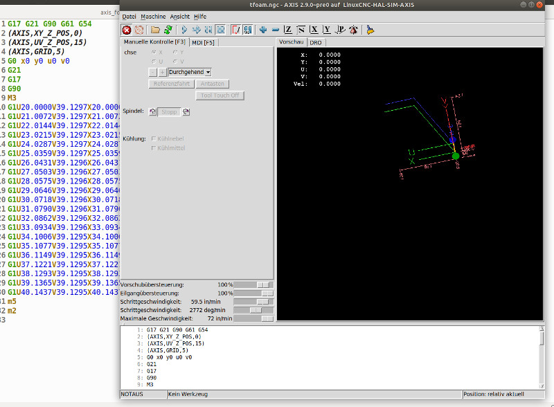

This is because your G-code begins with a G61
linuxcnc.org/docs/2.7/html/gcode/g-code.html#gcode:g61-g61.1
Try G64 instead.
Replied by andypugh on topic LinuxCNC with DevFoamWing
2) On slopes, it runs a line of GCode, pauses, runs the next, pauses, etc, etc. You can hear and see the motors run, run, run, run instead of just running from one end to the other.
Try G64 instead.

04 Oct 2019 01:48 #147067
G1 is correct. But there was a G61 at the very top of the file, which puts the machine in "exact stop" mode (it's a modal code)
- jeffgar2000@gmail.com
- Posts: 35
04 Oct 2019 02:14 #147075
by jeffgar2000@gmail.com
Replied by jeffgar2000@gmail.com on topic LinuxCNC with DevFoamWing
You are correct. I missed that. Other than that and the scaling being a little odd x10 it is running really well. I think we will run it a while and see what shakes out.
