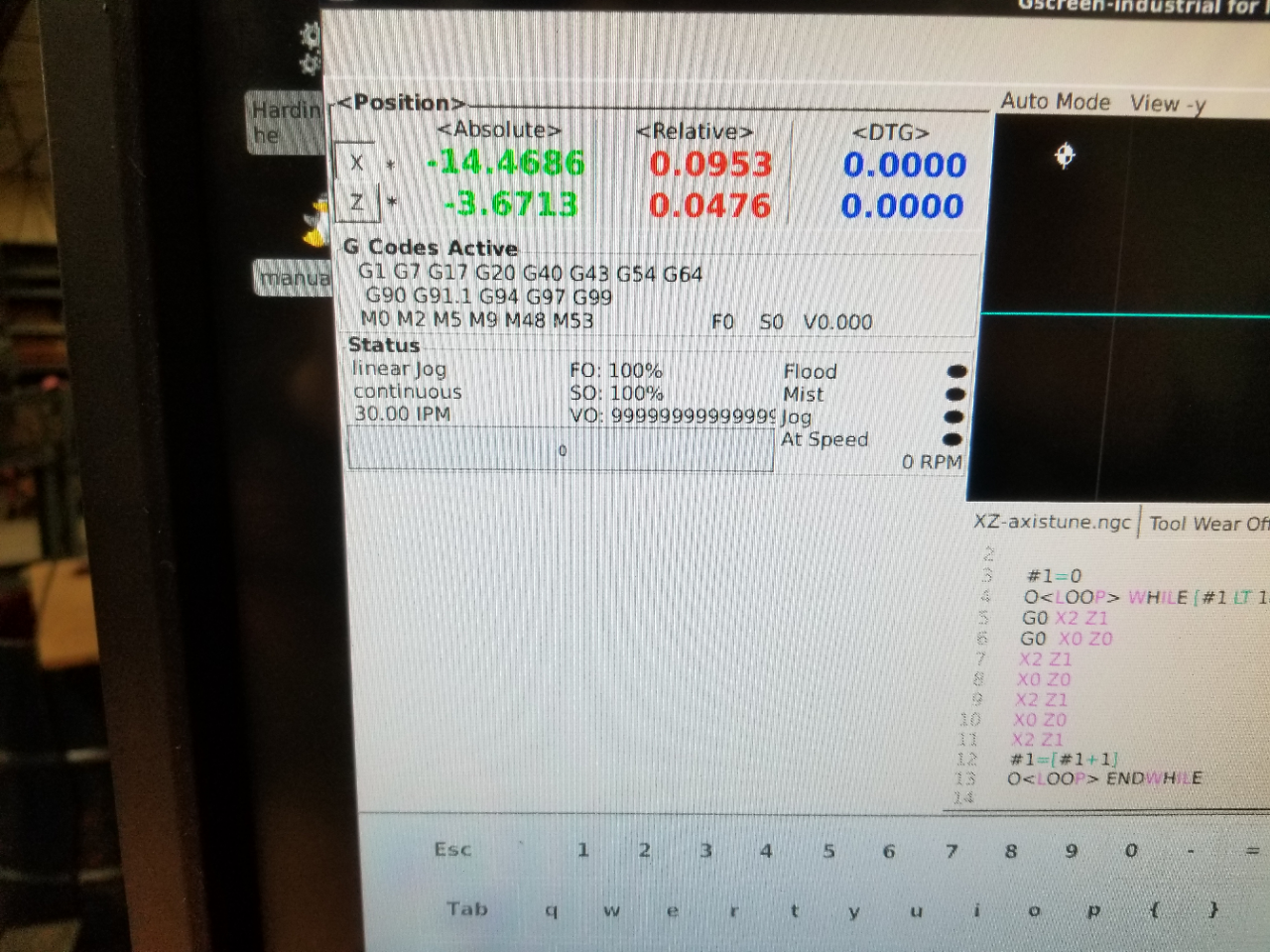

Here is a pic of my gscreen Industrial Lathe machine. My maximum feedrate is 150 ipm. Notice the rapid override is all 9's when it boots up. If I run like that my rapid speeds are 150 ipm.
If i hit the plus adjustment the display changes to 100% however my maximum speed is 30 ipm.
Any Ideas ?

Can you post your Ini file? I bet there is a missing entry.

I don't see an obvious problem in the code/INI
What version of linuxcnc are you using?

If you are using 2.7 try adding under the [TRAJ] heading:
MAX_VELOCITY = 2.5

I was away for the holiday also.
The MAX_VELOCITY fixed it.

If you switch to 2.8 + that entry will change.
