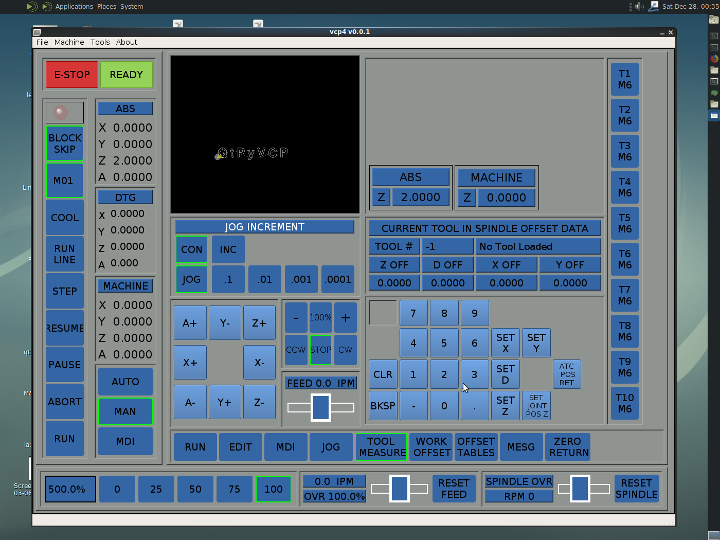

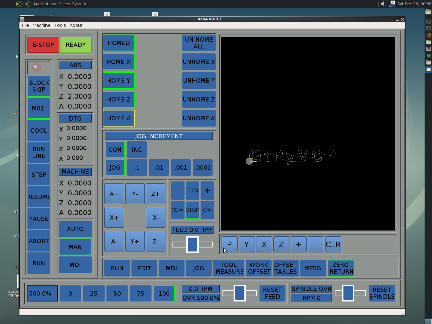

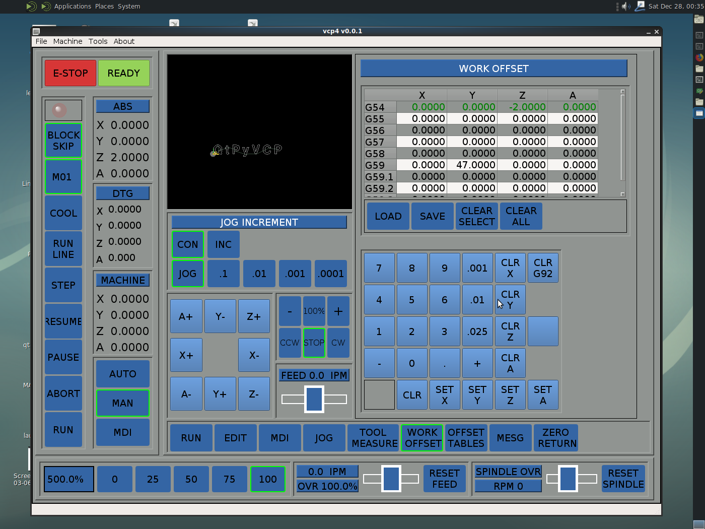

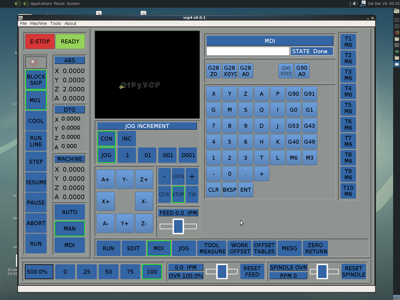

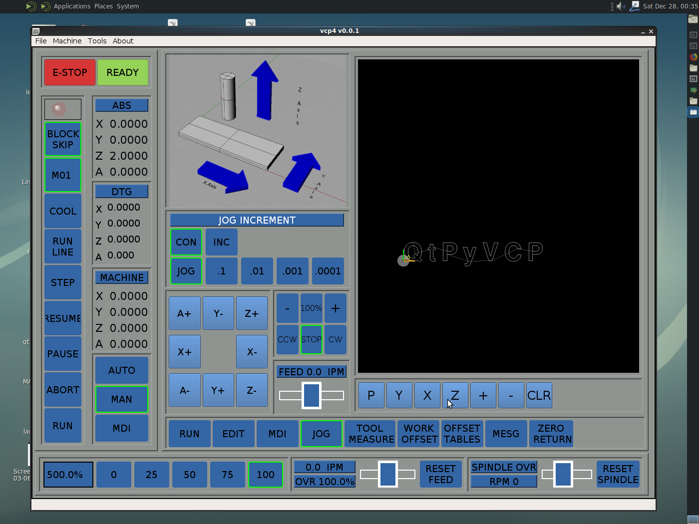

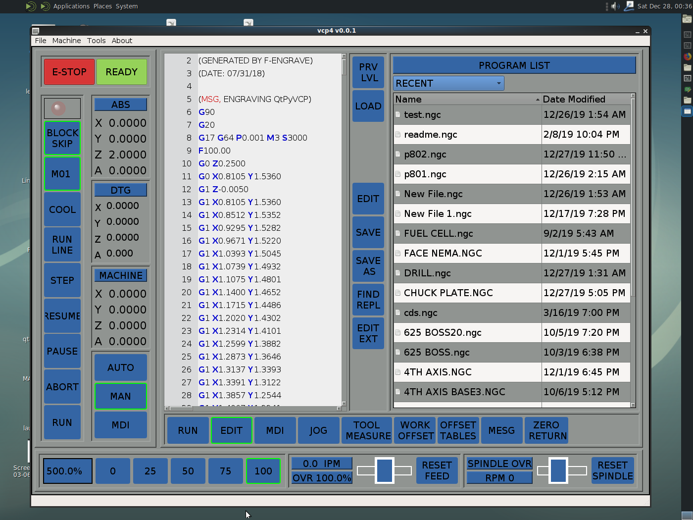

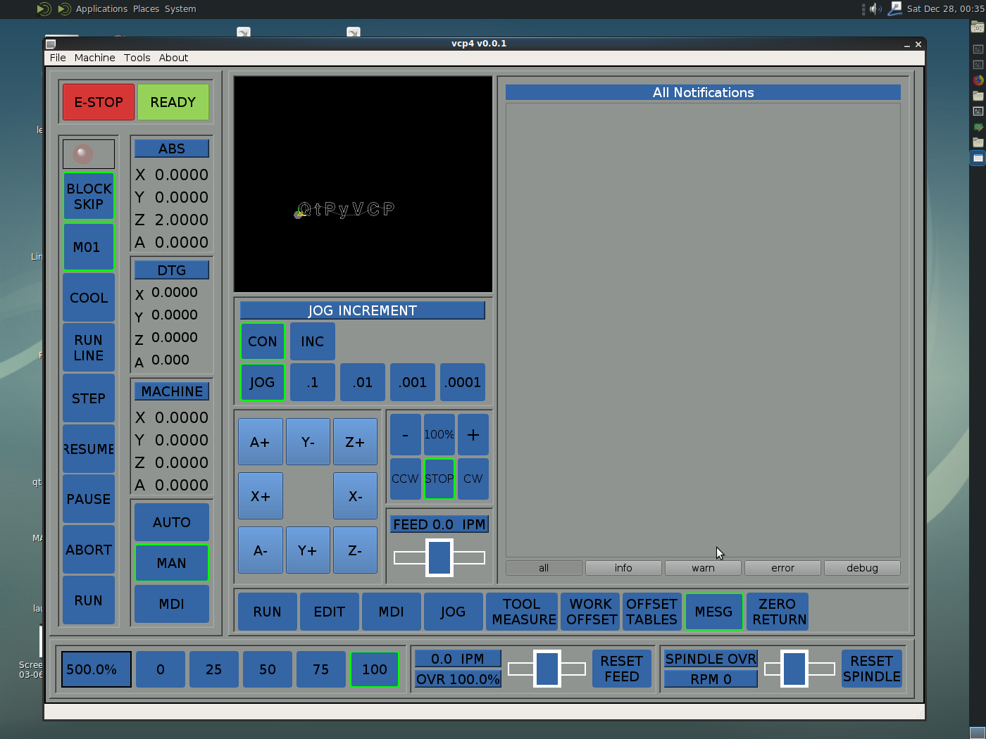

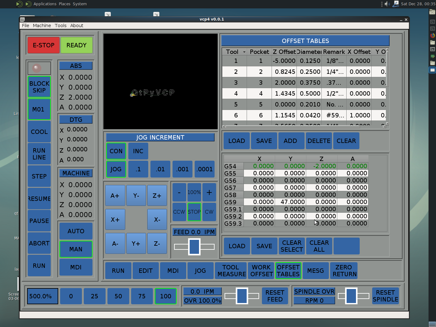

i started playing around with the stacked widgets rather than the tab widget. its easier to control what is seen on what area
i still have to finish theming some buttons and other things but i think i will like it the best
Some of the buttons I didn't want to change certain pages like the offset table page and notification page so I set the dynamic page proberty to a -1 and it only changes the right page. The tool length page and work offset page bring up the jog control page on the left.
Edit tab will switch to the large editor and file list.
I also set a signal to click the zero return page when the power button is clicked so you don't have to press it to get to the homing buttons

I took a look at the notification widget.py and it uses pushbuttons so they can be changed with a style sheet setting

The only other edit I made was simply change the notification widget.py to all capital letter s for the buttons
