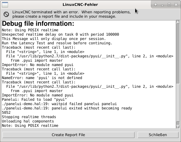

I would like to use panelui. linuxcnc.org/docs/devel/html/gui/panelui.html
But already the start of the demo fails.
What am I doing wrong?
Linuxcnc 2.9, Debian 9
Roland

From the error report:
ImportError: No module named pyui
Twice.

i have installed debian stretch using this iso:
cdimage.debian.org/cdimage/archive/9.12.....0-amd64-netinst.iso
I installed LinuxCNC following these instructions:
buildbot.linuxcnc.org/
These are the sources:
deb buildbot.linuxcnc.org/ stretch master-rtpreempt
deb-src buildbot.linuxcnc.org/ stretch master-rtpreempt
sudo apt-get install linuxcnc-uspace
sudo apt-get install linuxcnc-uspace-dev
Everything ist up-to-date
I tested it on two machines:
One is a virtual machine (VirtualBox). See linuxcnc.error in first post.
The other on is my real machine. Same result. See linuxcnc.error attached this post.

i tried LinuxCNC 2.8 in a virtual machine: sim starts without error.
I compared the files:
/usr/lib/python2.7/dist-packages/pyui/__init__.py and /usr/lib/python2.7/dist-packages/pyui/master.py between 2.8 and 2.9
and found some differences.
__init__.py 2.8:__init__.py 2.9:
master.py 2.8:
master.py 2.9:
i changed the entries .pyui to pyui and now i can start the sim in 2.9

ok that's weird ! I'm glad you found a work around.

Unfortunately this work around only works until the next apt-get upgrade
I hope this will be fixed in the master sometime

I see the change to .pyui was made durin the python3 transition.
I'm not sure why it was done. I'll inquire.
