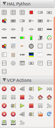

I created a GUI interface to use GTK, but I don't know how to clear the track after axis movement. Does anyone know? Can you help me solve this problem?

Yes, I do use gladevcp, but it has many parts. I'm not sure which part I should use.
Thank you for your reply

There are many buttons. I'm not sure which one to use

None of those buttons.
You must use python commands.
[widget name].clear_live_plotter()
also I think a mouse button double click will do it (probably the right button)

How should you use this function, do you have any examples, or where should I find the use method of this function

'graphics_widget' must be changed to the actual widget name in your Glade file.
then get a button to call this function.
Replied by cmorley on topic How to clear tracks
def on_clear_plot_clicked(self, widget, data=None):
self.builder.get_object("graphics_widget").clear_live_plotter()then get a button to call this function.

Sorry, I may still not understand what you mean. Is this (graphics_widget) the name of the interface where I want to clear the track?

oh I'm very sorry, I understand what you mean. I have realized the function of track clearing according to your method!
Thank you very much for your answer and reply! Thank you again!
