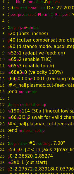

Hello all,
What is the best way to format the g-code display in qtplasmac? I am running 2.9.0-pre0 and have been playing with the screens in qt designer. The g-code display is all a single color driven by "Foreground" color in GUI settings. In the g-code, I am trying to highlight the M codes (yellow), make "X" and "Y" a different color (dark green) and in text comments another color (light blue). Being able to format the g-code display makes it a lot easier to ready. Any ideas?

Replied by cmorley on topic How to format the g-code displayed in QTPlasmaC
While in master branch you can select some of the colors:
linuxcnc.org/docs/devel/html/gui/qtvcp_w...s.html#_gcodedisplay
There are currently only 4 colors available.
To change the formatting further requires some coding changes.
The gcode formatting lexer is just something I quickly fumbled with a few years ago and never went back to.
I'm not a pro but if someone wrote up a requirement, I could hack on it.
Or better yet someone else hack it and I can commit it.
(The GcodeLexer class can be found in qtvcp's gcode_editor file)

Looks like Phill is a little bit restrictive on Gcode highlighting.
I'm sure he will chime in to tell you how to utilize the existing 4 colors if you want.
I did a bit of hacking and have code that can give individual colors to M, F and Axes as well.

You can set up some custom styling:
linuxcnc.org/docs/devel/html/plasma/qtpl...mizing_qtplasmac_gui
So you should be able to use any available styles for the gcode text:

20 Oct 2021 01:21 #223634
by Daddio
Replied by Daddio on topic How to format the g-code displayed in QTPlasmaC
Awesome, thanks guys, that did the trick.

I think that commented lines ( ; ) should be ignored:
I think that must be what Phill was talking about here: github.com/LinuxCNC/linuxcnc/commit/7c67...mmitcomment-58331334
I didn't know ; was legal comment code.
Fixed thanks!
