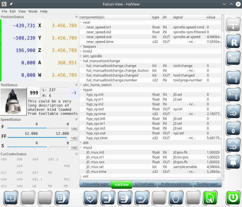

09 Jan 2022 14:37 #231249
by Reinhard
Replied by Reinhard on topic new project: FalconView
There's a belated christmas present:
Status of today :
Status of today :
- migrated to cmake build system (tested from commandline as well as from QtCreator)
- most main pages are plugins, that get loaded at runtime
- general toolmanager is able to generate tooltable for linuxCNC
- helpfile is complete for every available page and translated in english and german
- basic functions are already tested against LinuxCNC backend
- screen configuration is saved at application exit, so that it comes up as left

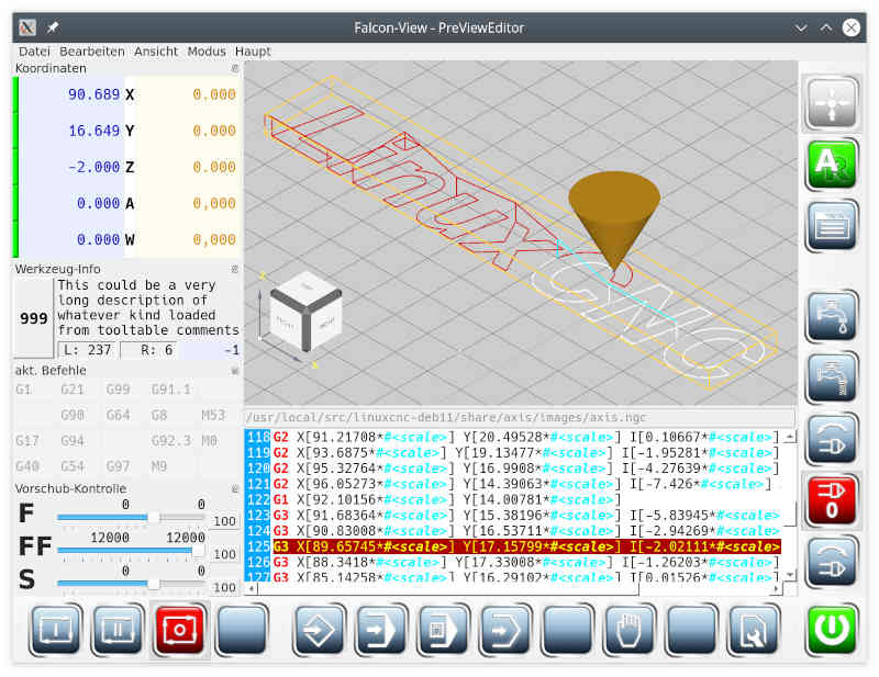

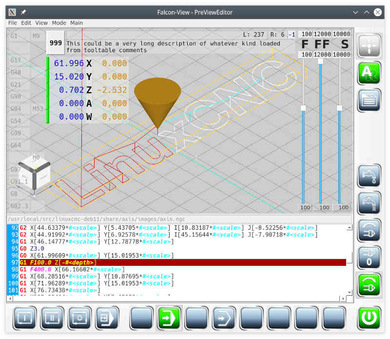

22 Jan 2022 16:55 #232797
by Reinhard
New update - new state: almost done
I solved all major problems and app provides now 3 layout variants:
- default: Preview is a splitted page with 3D-View on top and GCode-Viewer below. Switching to other pages hides 3D-View. Status-Info windows are floatable subwindows, that can be arranged around (fixed) center view or placed at the desktop.
- variant 1: status inside 3D-Preview. No more floating subwindows. All status infos are shown as overlay to the 3D-View. 3D-View and GCode-Viewer are still 2 parts of the same page. So changing to another page will hide 3D-View.
- variant 2: center is 3D-Preview only. Now the formerly center pages are placed in a floating subwindow, so it can be liberately placed somewhere around the 3D-View or put somewhere on the desktop. As other floating subwindows can do.
Status-Info and most content-panes are developed as plugins loaded at runtime. Plugins for content-pane may provide an action with icons, so they get an entry in a toolbar, which then loads that plugin page. I improved insulation of linuxcnc, so its possible to create plugins without linuxcnc dependencies (only one of all plugins actually depends on linuxcnc).
I used verbose coding, so the project may be used as blueprint or example app for Qt and linuxcnc.
Please test the app and give feedback.

- Grotius
- Posts: 2419
- Thank you received: 2349
23 Jan 2022 22:48 #232902
by Grotius
Replied by Grotius on topic new project: FalconView
Nice work Reinhard !
I see the toolpath done preview line in red and a graphics overlay. Nice !
Maybe sell it on embedded devices.

24 Jan 2022 03:42 #232921
by Reinhard
my project is completely available at github: github.com/DjangoReinhard/FalconView
With online-help in english and german. No hidden parts.
I would be more interested in giving it away to linuxcnc.
... about colors:
Most colors and fonts can be changed live. Buttons from left to right: foregroundcolor, fontsize, backgroundcolor
... about colors:

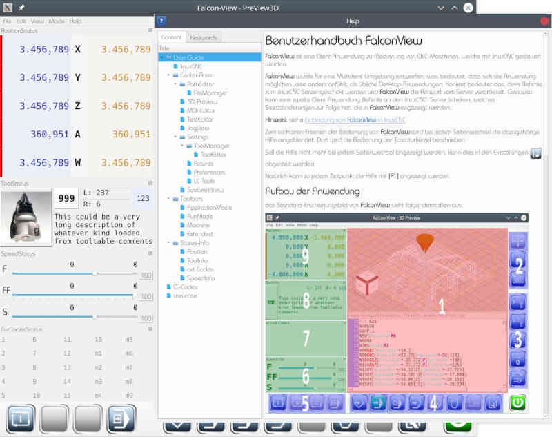

24 Jan 2022 15:42 #232975
by Reinhard
Replied by Reinhard on topic FalconView
Some of you know, that I'm pretty outdated. That leads to problems with default font of desktop and/or axis. Change desktop font is no issue with kde, but changing font of axis is not that easy. Lately I had big troubles with new release 6 of QtCreator. Got headache from that default font (and I found no way to change it).
Therefore default font of my app is user configurable.
For demonstration purpose I've choosen a quite exotic font - you can see the main menu and help content rendered with that exotic font.

25 Jan 2022 03:28 #233034
by Reinhard
> I came accros this example today :
github.com/gkv311/occt-samples-qopenglwidget
> It looks similar like your opencascade screen. I thought, is this coincendence?
Sure. I asked for help in occ-forum and got this sample as response. So I took it as blueprint to start with.
It already works on linux. You have to adapt the custom.pri file only.
I got code for 3D-circles from occ-forum too. But I'm not happy with it, as it is pretty complicated and I don't know how to verify that code. So if you know an easier way to create 3D circles, I would appreciate any helping hand.
Or may be you know a way to verify the generated circles ...
The point is, axis default sample gcode looks reasonable, but Cone moves outside the circles at gmoccapy_2_tools_with_cutter_radius_compensation.ngc - so I'm not sure, that the generated preview path is correct.
