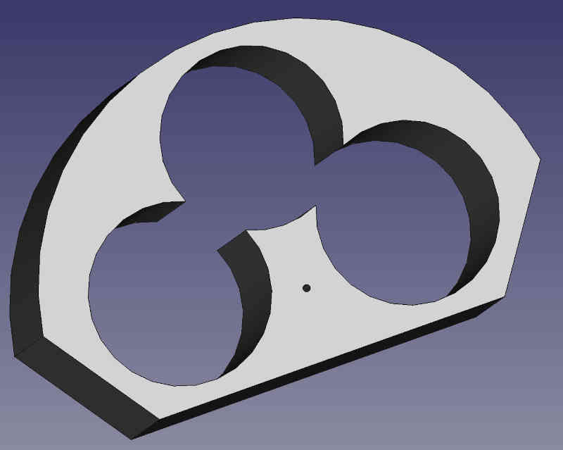

Suppose you have a lathe that support turning tools and you want to workout something like this:
The lathe tool can move in X and Z only, so to mill the circles you have to turn the main spindle into indexed C-Axis and the circle will be worked out between X- and C-axis. How would you like to render a path preview?
The straight parts of the outline should be milled too.

For the lathe question,
This is a difficult thing to imagine without full chuck, spindle preview.
My first thought was something like this.
If the lathe had one extra axis, it could perform like a xyz mill.
Doing the jog while rotating the main chuck forward and backward's is a difficult gcode path.
It can be calculated or be processed, but it's a hell of a job to code this.
No! No extra axis.
Hm, I guess, its similar to a 5axis-mill, where the table is fixed and the mill-head rotates (or a robot needs to perform similar moves).
Could that kind of movement be hidden in a tcp-kinematic?
