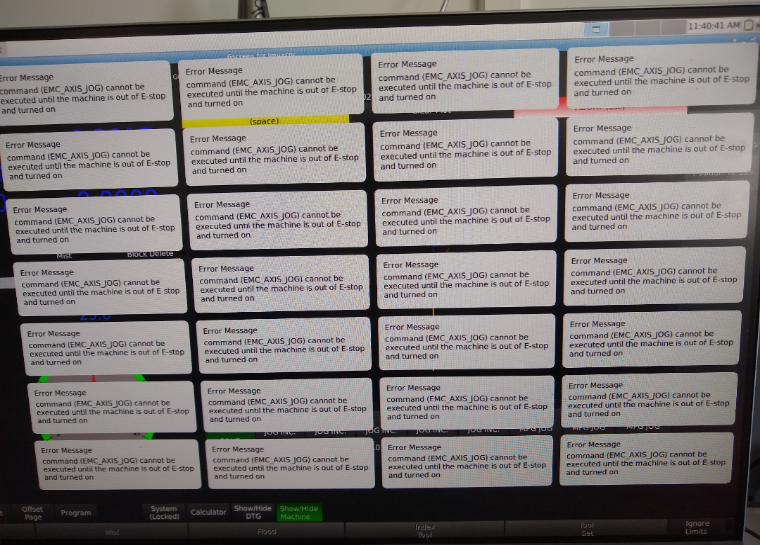

Ive added some limit switches to my machine which is currently using GScreen and everything is working as expected except for one issue. When im using my keyboard arrow keys to manually jog the machine and i trip any of the limit switches i get error messages that fill up my entire screen in a strange scrolling fashion . This does not happen when i run a program or use an mdi command and a limit switch gets tripped. I have no idea how to fix this....any help would be greatly appreciated.

my guess here is the keyboard release event is not caught so it keeps trying to jog and can't so errors.
It's been a while since I've been in the gscreen code but I could look later.
This is 2.8? Do you use compiled version or an installed version?

Next I wonder if you can post a pic of the multi error messages.
Finally can you run linuxcnc from the terminal and see if the terminal gives any clues.

here are some screen shots of the error messages im getting during a keyboard jog into a limit switch trigger. i did test the limit switch functionality with a mechanical switch physically wired to my 7I76 as a jog button and the error messages went away. i think that reinforces your assumption that the keyup event may not be detected.let me know if you have any ideas and thanks for taking the time to lend a hand.

Yes thanks for pics and your test.
I think if we cancel keyboard jogging on any caught error would cover this.
Now I just need to remember the code enough to make a patch to try
