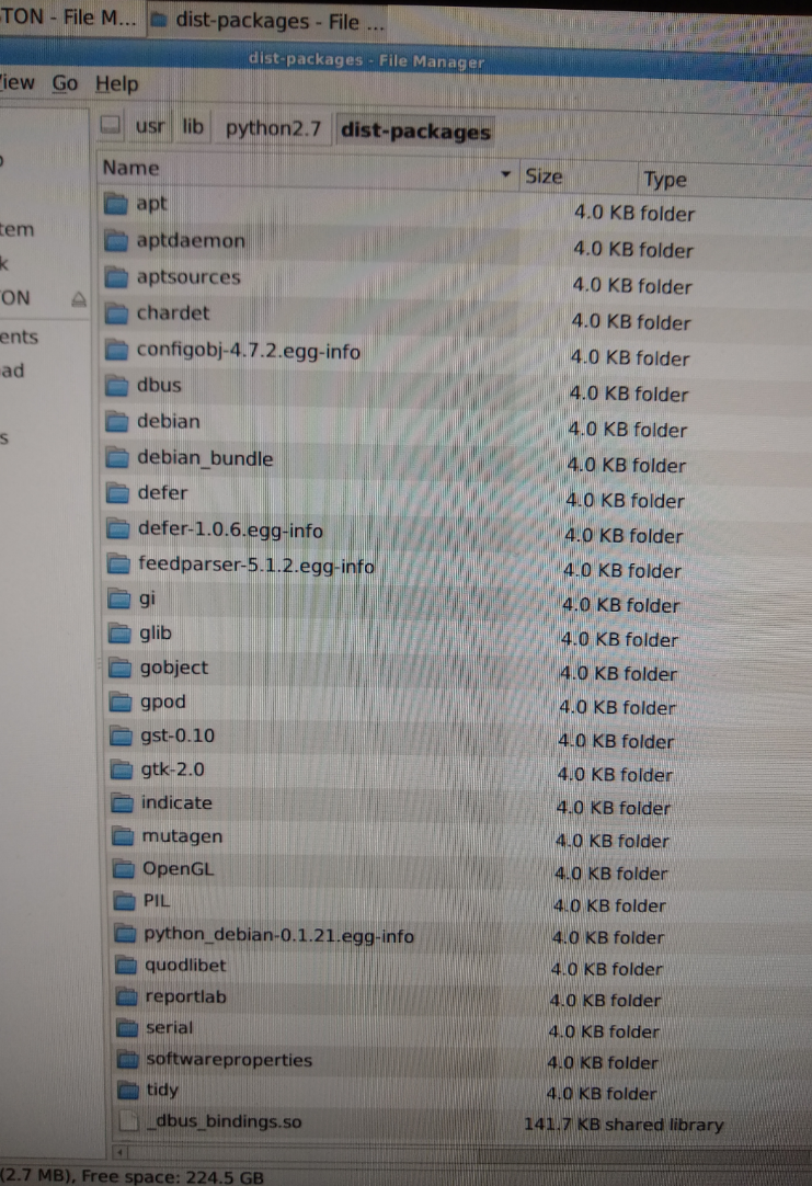

I tried to locate the EMC_Interface.py file in those directories and they dont exist on my machine......any suggestions? below is a picture of what i have in my /usr/lib/python2.7/dist-packages directory.

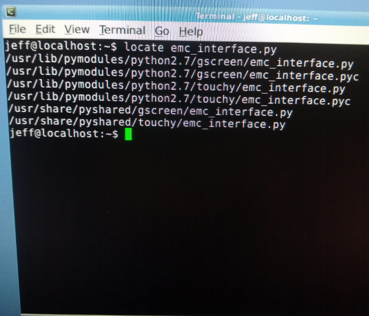

can you try this; open a terminal and run:
locate emc_interface.py
- Ivan_The_Red
- Posts: 83
09 Feb 2022 20:38 #234450
by Ivan_The_Red
Replied by Ivan_The_Red on topic GScreen limit switch issue
well, looks like i hit the jackpot.....which one should i replace?
- Posts: 7368
- Thank you received: 2182
09 Feb 2022 20:47 #234451
Replied by cmorley on topic GScreen limit switch issue
gscreen/emc_interface.py
please keep a copy of the original so you can go back if there is a problem.
You will need to be sudo to modify the files.
(There are other ways to do this but this is one way, use what is familiar to you)
in a terminal
sudo thunar
(depends on what system you are using, hopefully you have thunar)
should get you a sudo file manager
Using the sudo file manager, I would temporarily rename the original file then copy in the new file.
then kill the sudo file manager so you don't do any accidental damage.
Then try linuxcnc and see if i did any good

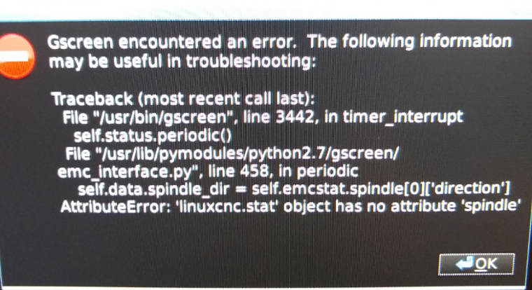

all went well with getting the file where it needed to go, got this interesting error message....image attached

i compared the contents of my original file and that modified version and it seems that my current configuration has problems with the teleop stuff as well as some other commands concerning the mode and even a few other commands. if your interested in pursuing this i could post my file and maybe something would come to light..... let me know
