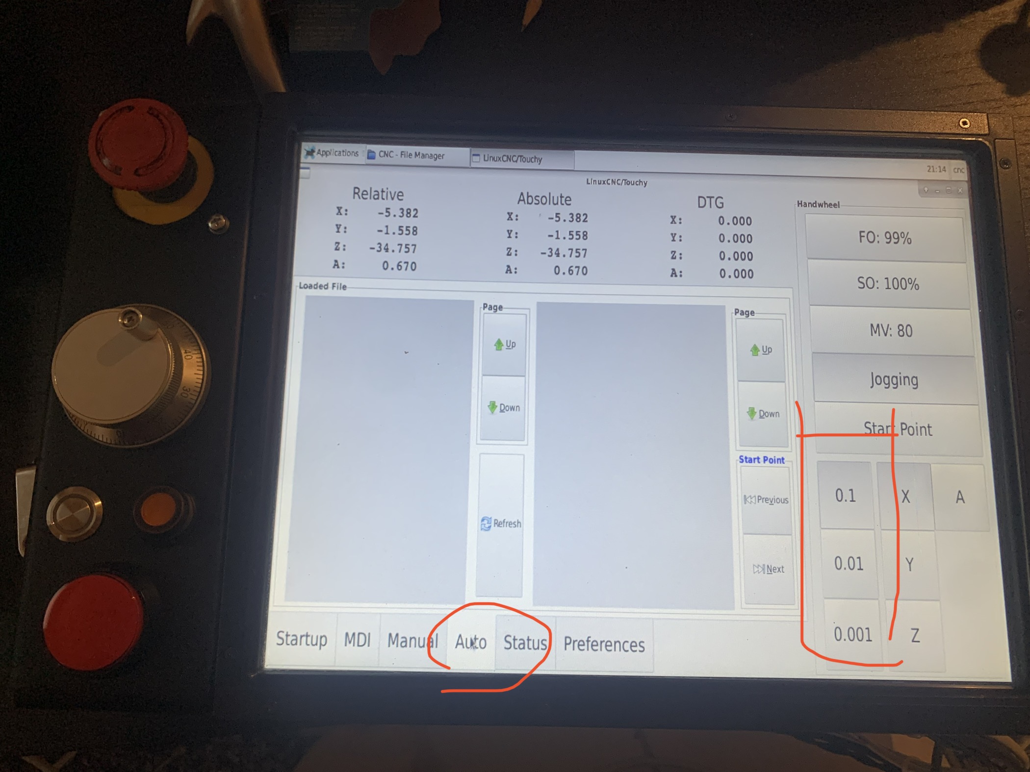

How to open NC file to touchy? and how to edit MPG scale buttons? was created by Karri

LinuxCnc is probably expecting a .ngc file NOT .nc
Check your INI file to find the line "PROGRAM_EXTENSION = .ngc XYZ Post Processor" or similar.
Replace .ngc to whatever you want (probably .nc)

Hey thx for fast reply, my bad the question was unclear.
I cant find ”open file” button anywhere :/

The "loaded File" left panel should show all the files available having the correct extension. By default this is .ngc but you can change this as I've wrote before.
Files are located in your home/"user_name"/linuxcnc/nc_files directory. Once you put it there it should show up in the "Loaded File" panel of Touchy (Auto tab). From there you just click on the file you want to use. Content will then show on the right panel.
