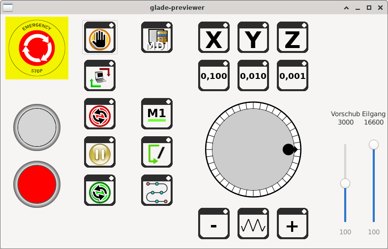

Just stumbled over this thread.
A while ago I started to prepare gmoccapy to be controled by external buttons. I know updates will not be funny. Maybe the decision would have been different if I found this topic earlier.
However my vision is to control machine power, machine modes and jogging by external buttons.
To reduce external buttons I would like to control machine functions in a, lets call it, semi touch way.
Adding as many functions as needed to the ui, Selecting/activating a function through the touch screen.
The selected function will put all possible selections on the function keys.
The execution of the function is done through a physical function key.
At the moment I'm working without hardware, so I'm creating a virtual panel.
So far the panel is working parallel to gmoccapy.
Once the panel is fully functional I will try to modify gmoccapy as close as possible to my vision.
Don't know how it will look in the end, but I like all the possibilities linuxcnc provides.
