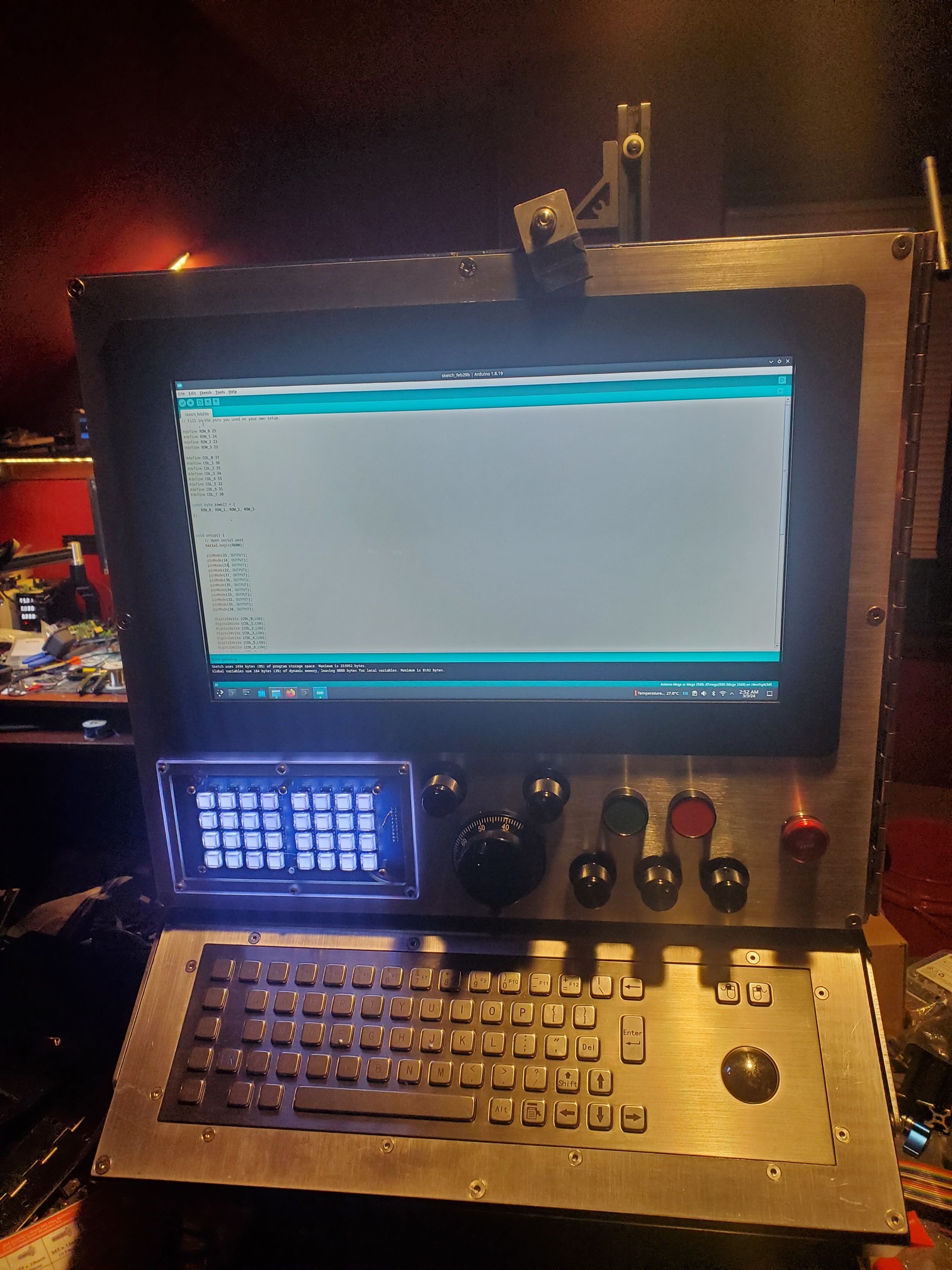

16 Mar 2024 13:29 #296063
by JT
Replied by JT on topic Flexible GUI
Flex GUI is starting to take shape...
JT
