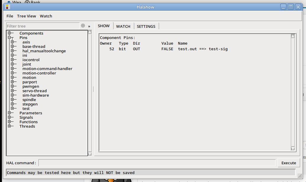

I'm a bit stumped on how to connect a PyQt button clicked signal to a HAL pin.
I can create a HAL pin and see it in showhal.
After a lot of grepping in src/emc/usr_intf I'm still at a loss how to connect the hal component to the clicked signal of a QPushButton.
After creating the hal component do you need to install it?
JT
parent.hal_test = hal.component('test')
parent.hal_test.newpin('out', hal.HAL_BIT, hal.HAL_OUT)
parent.hal_test.ready()After a lot of grepping in src/emc/usr_intf I'm still at a loss how to connect the hal component to the clicked signal of a QPushButton.

app.exec()and a video

This is working
Looks like the The HAL Python module docs are not correct...
JT
