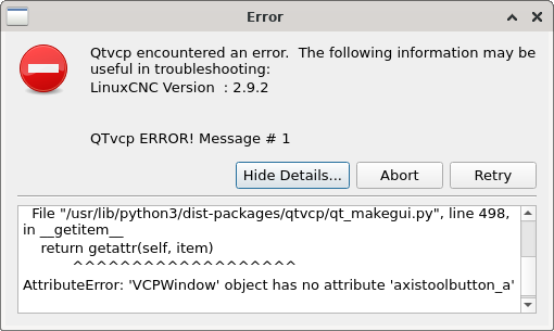

Hello everyone:
when i enable SETTINGS -> USE VIRTUAL KEYBOARD ,I got an err like this:
I just start a sim config

Sorry I have missed thus. This has been fixed in the repository.

But what should I do? I used: sudo apt-get update/upgrade command and the problem still persisted. Then I used the Synaptic package manager to reinstall LinuxCNC and it still didn't solve the problem.

Sounds like you are using the official Debian repositories to get linuxcnc.
That repository is very out of date and will not be updated anytime soon.
The best way is to use linuxcnc's buildbot version.

When I upgraded to the latest version, the problem was solved.
The following tutorials I used:
forum.linuxcnc.org/9-installing-linuxcnc...t-on-debian-bookworm
