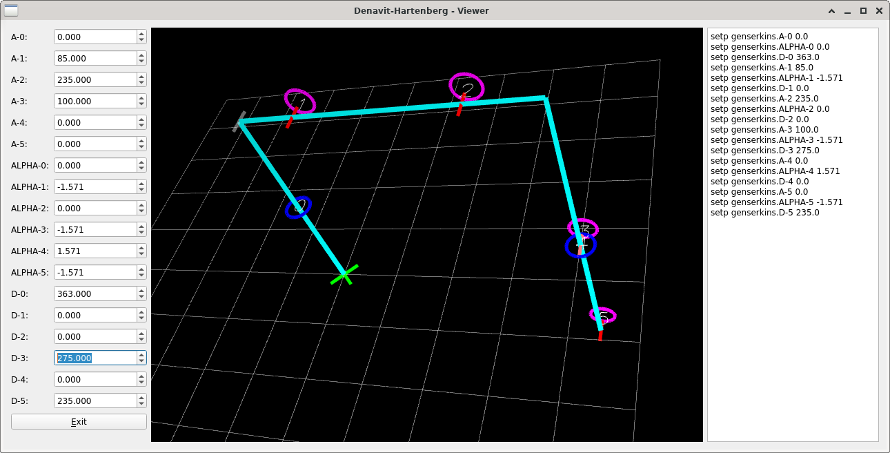

this program is specially adapted to my needs. I use a Parol6 with melfa configuration and RC servo gripper via analog output (M68).but perhaps also interesting for others
this software can log world and joint possitions, as well as the gripper.github.com/multigcs/linuxcnc-robot-logger
