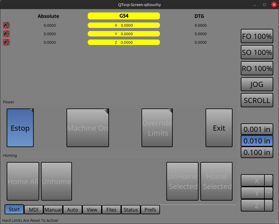

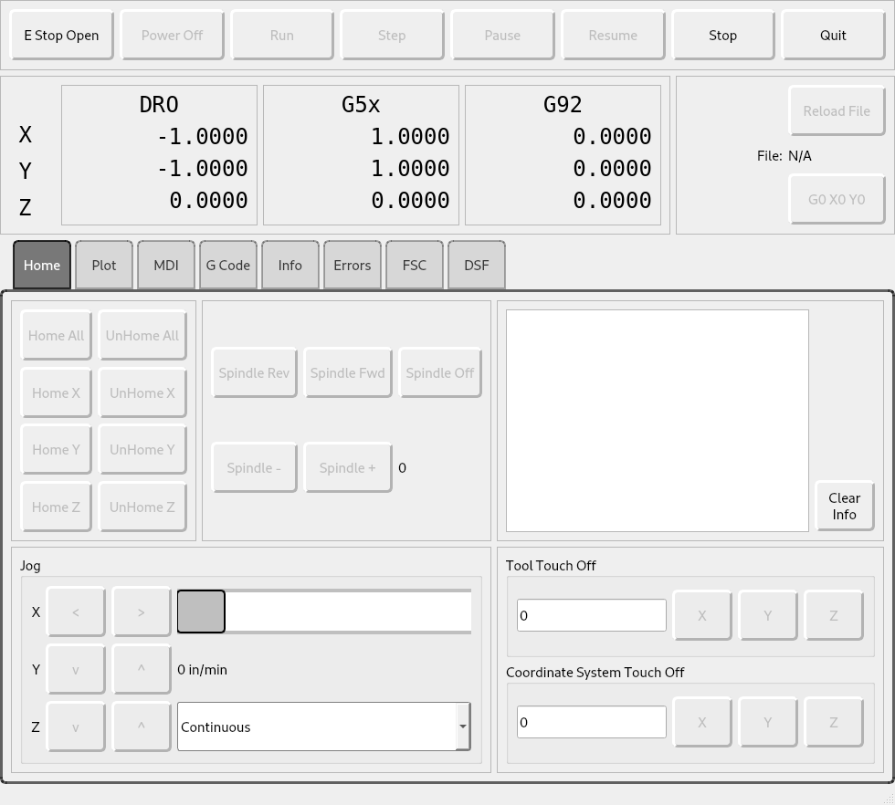

- Posts: 7368
- Thank you received: 2181
30 Nov 2024 21:27 #315702
Replied by cmorley on topic Touchy error
There is QtTouchy available in linuxcnc as well.

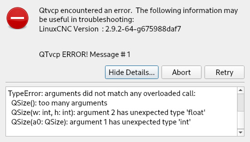

01 Dec 2024 15:27 #315758
Hey John, can you run it in a terminal so I can see what line the error came from?
Newer versions of Qt are picker about ints and floats.
