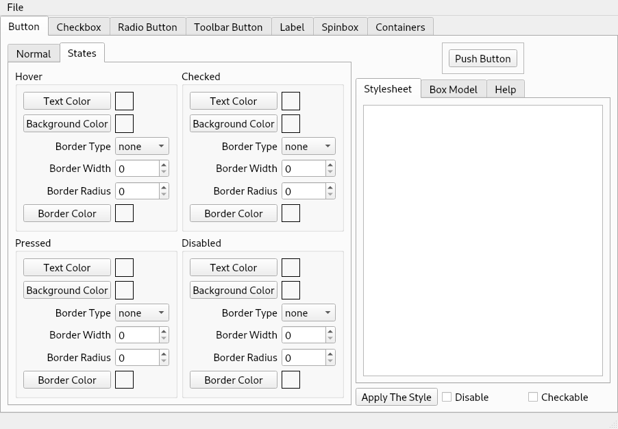

23 Dec 2024 14:14 #317198 by JT
Flex GUI Stylesheet Builder was created by JT
If you don't understand how to build a QSS stylesheet then Flex has the solution for you a stylesheet builder.

26 Dec 2024 14:08 - 26 Dec 2024 14:40 #317403 by JT
Replied by JT on topic Flex GUI Stylesheet Builder
The stylesheet builder now has QPushButton, QCheckBox, QRadioButton and QLabel.

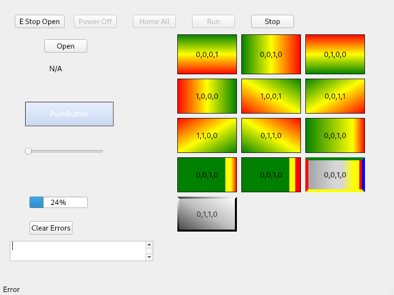

10 Jan 2025 14:53 #318635 by JT
Messing around with QLinearGradients and thinking of adding them to the Stylesheet Builder.
Is it worth it?
JT
12 Jan 2025 02:17 #318729 by blazini36
Replied by blazini36 on topic Flex GUI Stylesheet Builder
Is it worth it?
JT
A gradient would be good for something like a progressbar unless there's some other way to express zones.
Was messing with the qss builder a bit.....it definately needs an "open" function.
Also doesn't seem to be any way to apply the background colors. I assumed this would be part of "All" but it doesn't seem to work like that.

12 Jan 2025 10:35 #318749 by JT
Gradients can be used to style buttons etc.
What would the open function do?
Can you elaborate on apply the background colors?

12 Jan 2025 11:03 #318753 by blazini36
"What would the open function do?"
If you use flexqss to make a qss file then close it, your done. You can't edit it after the fact without some File->open type function. There's an awful lot of different selections to make having to make them in 1 sitting.
"Can you elaborate on apply the background colors?"
How do you change the background color without using a theme in the ini? If you specify a qss, the theme doesn't work.....or at least that's what I'm seeing. From my setup, it's either use a flex theme or the background is white.....and my qt theme is dark on my Debian VM. Designer preview shows my ui as dark, launching LinuxCNC with a qss specified it is white....so maybe I'm missing something.

12 Jan 2025 15:49 #318786 by JT
I can see the usefulness of being able to open a qss file and set the various widget stylesheet properties.
Yes it is either use a theme or create your own qss stylesheet and use that.
As for the main window background color I need to add that but in the mean time...
/***** QMainWindow *****/
QMainWindow {
    color: #ffffff;
    background-color: #121212;
JT

14 Jan 2025 15:14 #318950 by JT
I started adding containers and a gui you can pop up to view all the changes in one place.
